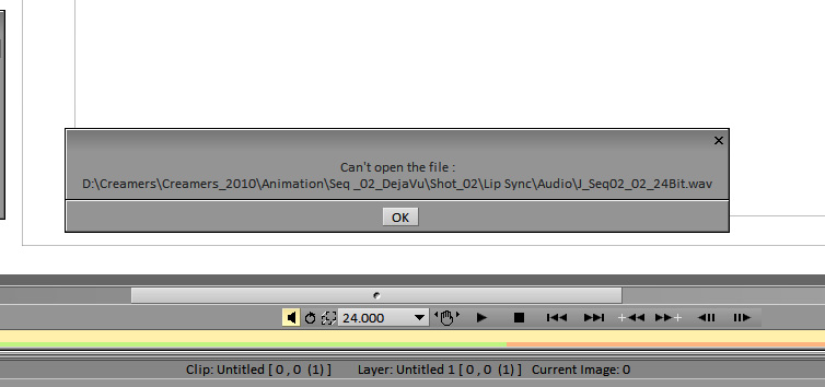

Hi -
Is there a way of preloading audio files into a TVP project - can't seem to find this anywhere. Also I have a wav file that works fine in TVP 9.5 but when keeps being rejected by TVP 10 (it says either it can't find the file - even when I have just opened the directory and selected the audio file) or it says it can't open it. Anyone else have audio file conflicts with TVP 10?

Thanks Paul - Ok so I am not missing some obvious button- I am on Win 7 - and as I write I am having to revert to TVP 9.5 because 10 won't accept this particular audio track...

Ok - so figured it out - TVPaint 10 won't open 24 bit audio - changed it to 16 bit and it loaded OK...strange that 9.5 will though...

I have done a comparison with other audio files that have worked and the kHz doesn't seem to be the issue (both 44 and 48 work) its just the 24 bit integer on that file seems to be the sticking point in not loading in TVP 10. I can send you the file if you want Fabrice. With regards to the preload I was hoping there was a way to just send one TVP file when working with others as opposed to folders and multiple files (that is the TVP file then all the audio files). I get the idea of setting up folder structures its a 'collect file' option that would be helpful (like AE) when transporting projects.

Oh - I just checked the preferences Paul - and the sound options show kHz but not intergers... I just converted another audio file that previously loaded into TVP 10 at 44kHz 16 bit to 24 bit (keeping 44 kHz) and it wouldn't open. So I am pretty sure its the integers not any corruption on that particular file.

But I work with files like these all the time -- actually a vast majority of my files are 24bit.wav files. How can it be a TVP issue? I'll even go so far as to guess that a vast majority of TVP users use 24bit.wav files. Doesn't that point to something being amiss on your end? It might be interesting if I sent you several of my files to see if you can open them... would you like to try this out?
