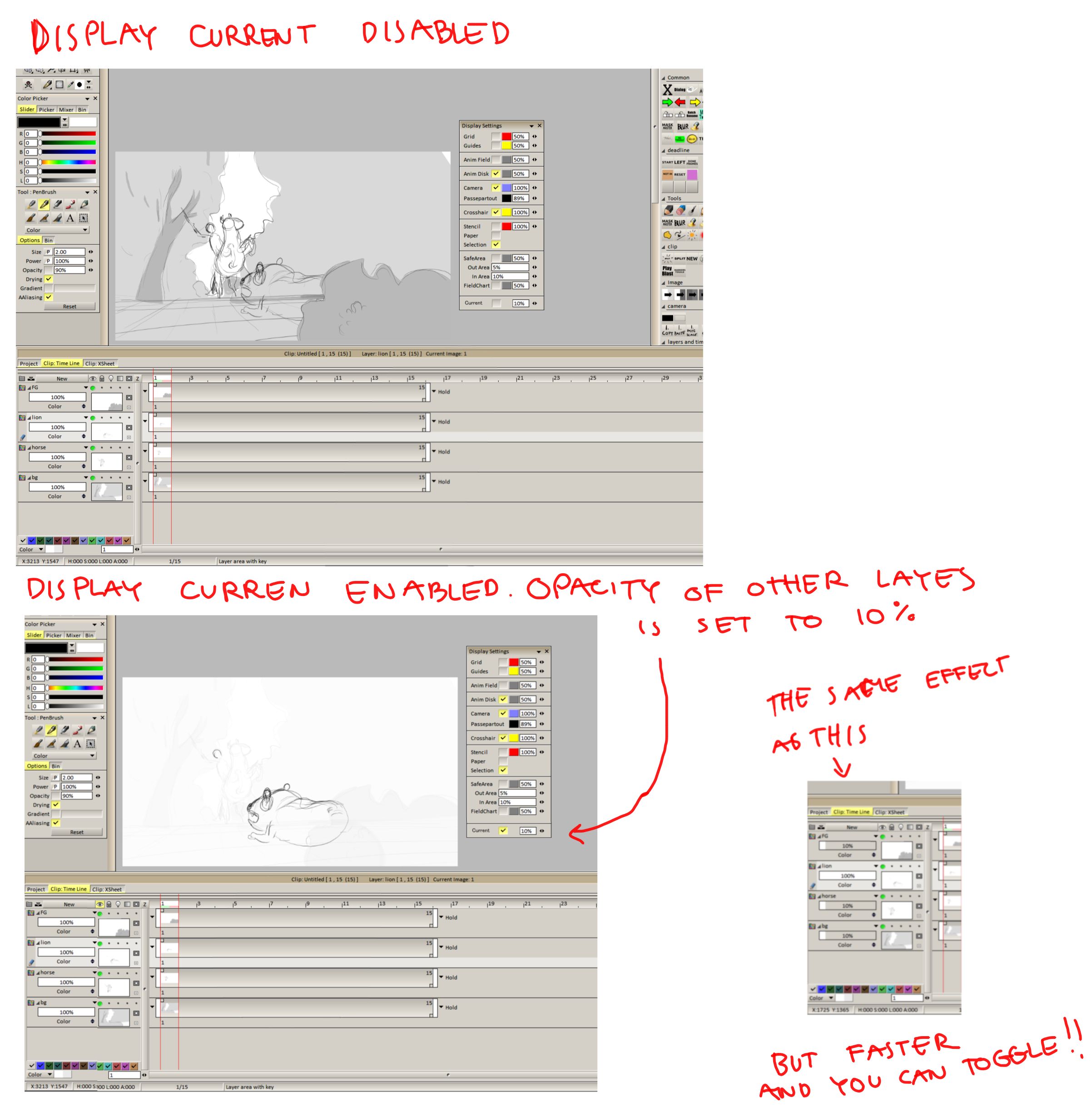

Re: Set opacity of other Layers when "Display current"
Here's an illustration of my request
-Mads
When I sat the transparency of the other layers. I noticed I had drawn some ogf the riders head on the lion layer. That's exactly why this is a great feature. to prevent this.-Mads
