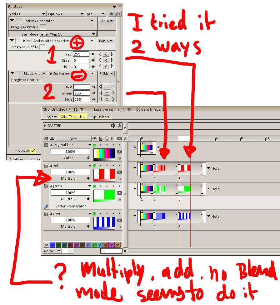

Posted: 14 Mar 2012, 09:12
by Peter Wassink
ematecki wrote:Peter Wassink wrote:no luck yet
You have to set the background to "None", not "Color".
i did (though not in the screenshot
![Confused :?](./images/smilies/icon_confused.gif)
but as Zig pointed out, the 3 grey channels have to colorized using Multiply and not colorize/tint and that was where i went wrong.
Thank you all
