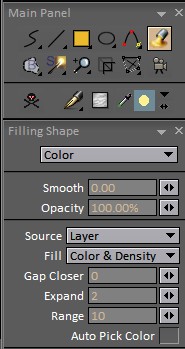

I guess I should have been more exact. The critical FloodFill, Filling Shape properties that I can't access or set are as follows:
Source: with four options - Layer, Above, Below, Display (all useful in their own way)
Fill: with five options - Color & Density, Color Only, Density Only, B Color, Luma
Gap Closer: numeric value
Expand: numeric value
Range: numeric value
AutoPicker: a check box (on or off)
Perhaps a new pair of commands: tv_GetFillingShape and tv_SetFillingShape as in:
tv_GetFillingShape
parse result xSource xFill xGap xExpand xRange xAutoPicker
As you say, all the other important FloodFill settings can be read and written using tv_GetActiveShape and tv_SetActiveShape.
