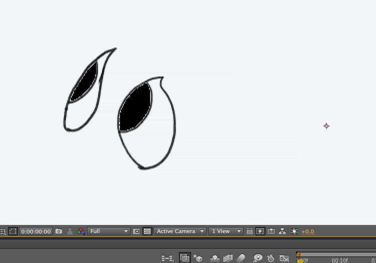

My sequence looks okay until I play it. It looks pixelated around the image and when I export it(.MOV with ALPHA) and bring it in AfterEffects
and put a white back ground behind it I can see some unwanted lines that I've know idea where they are coming from.

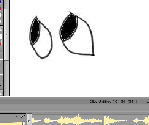

Also if you notice when I filled in the eyes, it doesn't feel it fully, there is a white line around the whole thing. Not
sure how to fix that.
The top picture is exported and is on white background.
The bottom one is in TVP.
I really appreciate any help.
Pixelated around image when playing.

Re: Pixelated around image when playing.
hi Mariam and welcome,
for the "mysterious" lines (artefact ?), I think it's relative to your exported file,
try to export your anim in images sequence (PNG32 or TGA32) instead of a quicktime file (.MOV),
concerning the "uncomplete" filling, you should tweak the fill settings a little bit more,
f.i., add 1 (or 2) pixel(s) in the "extend" parameter, and fill the areas in "Behind" painting mode,
it should solve this undesirable white pixels around the lines.
