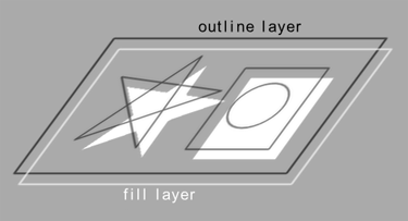

1. Make sure you have created a FILL layer BELOW you’re outline drawing layer, where your filled shapes will be formed.
2. Make sure the Bpen color is set to the color you want to use for filling.

3. When the full-screen crosshair appears, click your stylus or Left Mouse Button on an area OUTSIDE the figure.
4. That's it… all closed shapes will generate opaque BPen Color fills on the next layer down in precise registration.
The background areas remain transparent and all of the enclosed figures will show as filled with the Bpen color you chose (on the fill layer below).

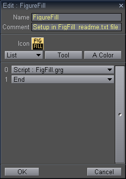

my fisrt question is : why don't you use Embedded Script ?
I am looking for your FigFill.grg file everywhere on my HDs, no way to localise it,
and my C:\Program Files\TVPaint Developpement\TVPaint Animation 10 Pro (32bits)\George folder is empty ...
if for the next release, you copy/paste your george script to make it "embedded", the script will be definitively part of the tvpx file,
I think it's the best way to share buttons with script(s) inside .

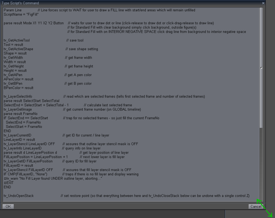

Zig: I tried to use embedded scripts but gave up: the little window editor is rather flaky and SO small... comments are out of the question. It's like building a sailing ship in a bottle for me - but your argument about keeping all the components together in one place is a point well taken. I will experiment.
Meanwhile, if I can find a solution to make FigFill work as advertised, straight out of the zipped file, I will post it later in this thread.

You can use any editor, and just copy/paste into that tiny window.Svengali wrote:Zig: I tried to use embedded scripts but gave up: the little window editor is rather flaky and SO small... comments are out of the question. It's like building a sailing ship in a bottle for me - but your argument about keeping all the components together in one place is a point well taken. I will experiment.
Re: FigureFill - one-click to Fill Line Drawings
Svengali wrote:...
ematecki wrote:... You can use any editor, and just copy/paste into that tiny window.
Haha. I never noticed that the embed editor window was scalable, which helps a bit.ZigOtto wrote:do you mean you both don't have a resizable script window as I have here, (and that since several builds I think) ?
However, the whole development cycle for a fairly complicated script, especially one which requires dozens of edits,failures and retries before it finally begins to work as intended, followed by many more iterations in which the essential parts are refined, commented and made friendly is something that could only be done in a real-world programming editor.
The main reason I comment my scripts so heavily is so I can use earlier scripts as reference when constructing new scripts. Multiple-windows, function and template libraries, syntax color-coding and checking... and sophisticated cut and paste tools are a few of the things even the simplest code editor provides. (I use something called TextPad which is very basic, but streamlines what I need... it's inexpensive with frequent, free updates.)
Another thing about embedding scripts that has bit me a few times is the overhead in keeping all duplicate button clones (with their individually embedded scripts) current. On the other hand, if all my cloned buttons call out to the same script, then any frequent changes in the script will work with all similar buttons.
On Ematecki's advice I will try cut-and-paste embedding with this and other distributed scripts to see if TVPX bundling works better that way. It simply requires that I be more diligent separating development scripts and all their variations from the distributed final version of my script.
