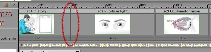

Editing Durations
screen shot of Clip:timeline view
If i drag the marked border between the two clips to the left every clip after it moves as well. If I tweak one edit I then have to correct all the edits after it.
What I would like to be able to do is to have the option to drag it and have the end point of the second clip stay where it is. Perfect for finessing edits:-)

MrChoy wrote: If i drag the marked border between the two clips to the left every clip after it moves as well. If I tweak one edit I then have to correct all the edits after it.
+1
in Adobe Premiere it is called "rolling edit" http://www.mediacollege.com/adobe/premi ... lling.html
and when timing instances. it is like dragging the top left instance handle. What about handles on clips. like the instances?

I suggest that if you are moving an edit point between two clips and only one or two clips are selected at the time you are dragging, the results should NOT affect any other clips. Only the selected clips. Simple.
In premiere, you have the rolling edit tool. But, also in Premiere, using the plain old Select tool transforms into an inpoint/outpoint tool when you hover over the cut on a selected clip. If you are adjusting only one clip's in point or out point, other clips don't change, unless you have multiple clips selected. Less relevant, but possibly of value: it's possible to edit multiple clip in/out points at the same time. Also, if you want to affect all clips along the timeline, it's quick to do this: you can select all clips on an entire track(s) from the selection time onward, then drag them in time.
