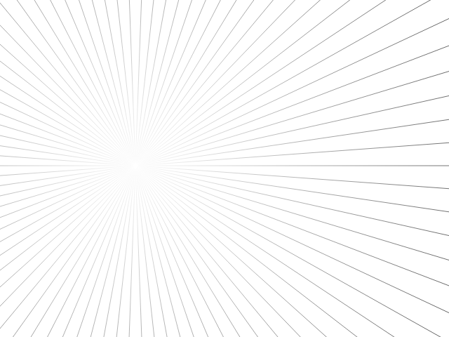

I've made this brush to serve as a vanishing point tool for creating perspective grids. It's a fairly simple set of radiating lines, which is scalable and can be modified by the Tint brushes in the Sketch Panel. I hope you find it useful.

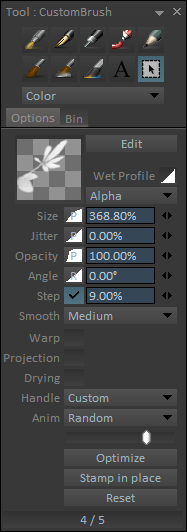

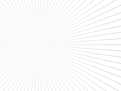

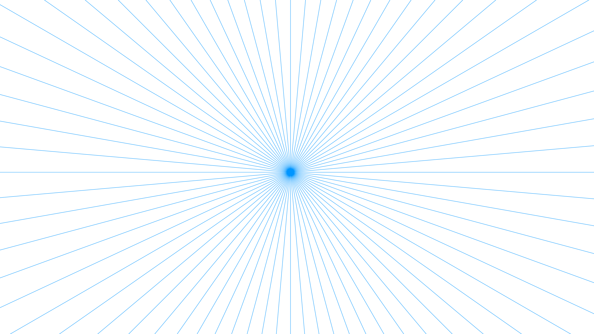

This is a rather heavily modified version of KylerK's vanishing point tool.
Spoiler : Kyler's tutorial video :
This version automatically switches you to the propelling pencil and restores your brush afterwards.
It makes use of the tv_undoOpenStack and tv_undoCloseStack commands to avoid clobbering your undo buffer
It locks/unlocks the display during operation for faster results.
It also uses tv_zLine to fade the opacity at the center point to eliminate the "fuzzy navel" artifact at the vanishing point
Using the first script
Code: Select all

This one is a little different in that it randomizes the angle and the distance to the center point. It doesn't affect the current tool, so it's useful for various zooming effects.
Using the second script

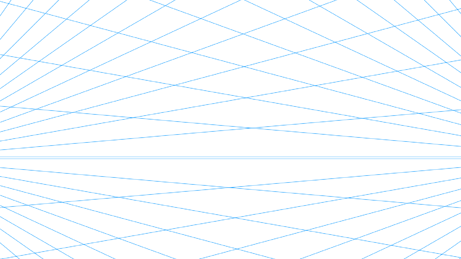

Post by lemec »

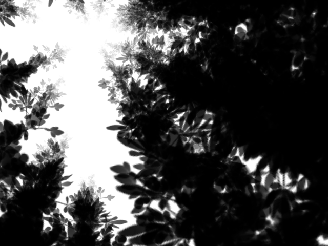

With the right settings...
(Win7x64, TVP Pro 11 32-bit)

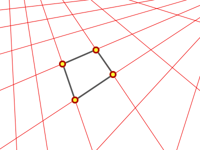

lemec wrote:Hm. Maybe I should make a version that will set the vanishing point to the intersection of two non-parallel lines. Might be useful for getting perspective guides for imagery that has an existing vanishing point.
you mean a version with an input of four points that would create a grid to match an existing image?
cool idea!
Re: Vanishing Point Tool
+1. That's something so fundamental, yet I haven't seen it in any graphics program yet: let the user create a rectangle or tetragon, and the script would create a grid of that. Adjust the original tetragon, and the grid changes with it.
