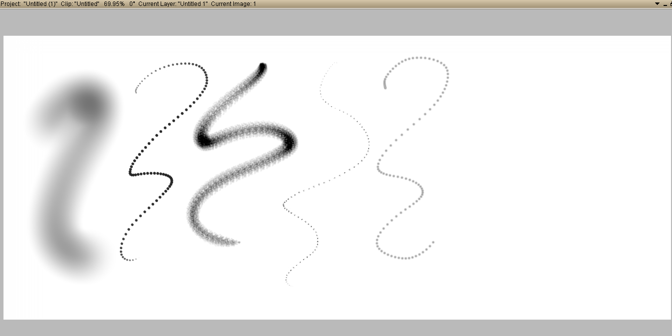

Hello!
I'm running TVP Animation 9 Pro on my PC Desktop/Cintiq. My brushes, however, turn out "spotty." I seem unable to make a smooth line unless I draw slowly. I've attached an image of what the brushwork looks like. I've tried adjusting the brush settings, but it doesn't seem to make much of a difference. Is this just how the line quality looks for TVP, or perhaps I am dealing with a graphics card issue?
Thanks!
Roselle2
Posts: 378
Joined: 22 Nov 2007, 14:50
Re: Unable to make a smooth line on TVP9
Post by Roselle2 »
:? Hi,
Go to Tool:Penbrush and look Size and Power and so on.
Your Options not correct.
Size =P and Power =C than it is good.
look also Main Panel , The first Brusch are Line not Dot.
Roselle2
Posts: 4522
it could either be that in the main panel your drawing setting(first button) is Not set to Stroke but set to dot. (like Roselle said)
or, when it is a custombrush you are using, it could be that in the tool panel the step mode is on (or set at too high a percentage)
idragosani
Posts: 987
Joined: 06 May 2008, 00:39
Location: Germantown MD
Post by idragosani »
yukilin wrote:Hello!
Thanks!
You have the 'dot' stroke selected for lines rather than the freehand 'line' stroke. This is selectable on the Main panel in the top left.
yukilin
Posts: 2
Joined: 29 Aug 2012, 20:42
Post by yukilin »
Ah! I did indeed have the dot stroke selected. Glad that was an easy fix. :) Thanks so much guys!
