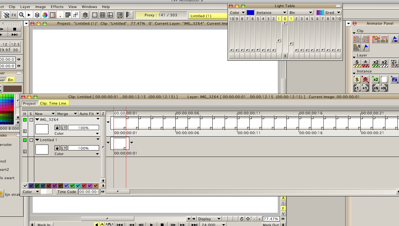

With these settings...
Schermafbeelding 2012-11-15 om 20.56.34.png (58.88 KiB) Viewed 8485 times
quicktime 10.1...do you happen to know if there are specific settings I need to use in order to see the .mov as an image sequence?
this is what i see..

found it!...the problem was that the mov I was trying to upload was apparently only suited for Iphone and Ipad iguess. I renamed it in quicktime and now it works!. thanx for your help!
