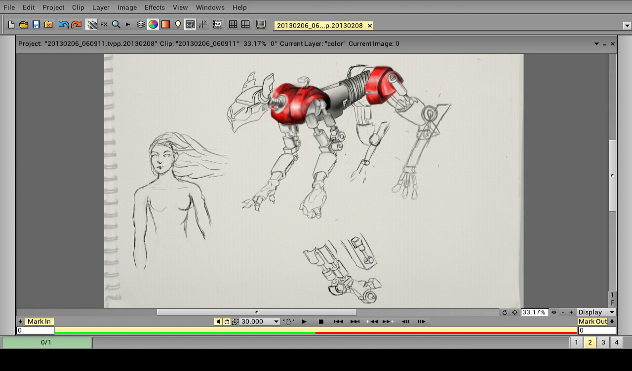

Sketched on paper took a pic with the note tablet,  imported, now I'm working at it in tvpaint.
