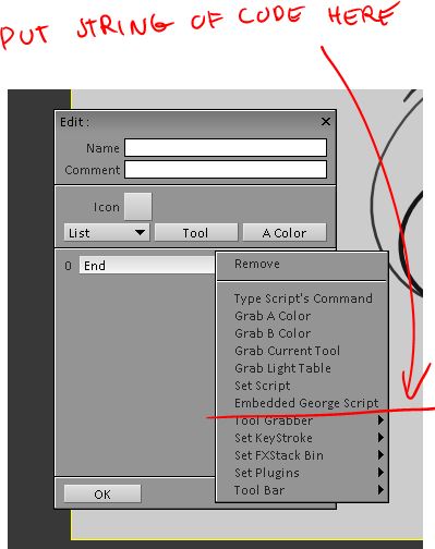

While we are waiting for a Keyboard shortcut you can use Tvpaints scripting language sor setting the stamp drawing mode of a Custom brush .
Paste this code
Code: Select all
tv_BrushRestore stamp 1
Into an embedded George script in an Action
Even though we can do it this way, I still think it should be availeble throug the Keyboard shortcuts
-Mads

Thanks so much Mads! :) Exactly what my sketch panel needed! (Easily stamping parts of drawings in blue!)
