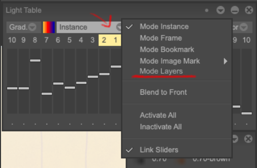

Very old request, and I still do not see any progress on it. So bumping up my suggestion again - any thoughts? Adding a Layers Mode option in the Light table panel menu still feels like the most intuitive option to me.

i must say even after reading this thread i don't fully understand what this would add that can not already be done?
i also find the name "mode layer" very confusing as layers are orientated vertically while all the other options are all referring to horizontal units.
