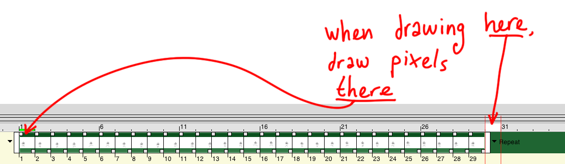

When the end of a layer is set on 'repeat' it would be cool to still be able to draw in the frames if you're outside of the actual frames. It would animating cycles even easier :)
See attached picture:

Just stretch the last frame out to the clip's end as a single instance (I have a plugin with which I can do this in one click of a button)and using the Faux Fix you'll be able to do what you are asking for.

Paul Fierlinger wrote:Just stretch the last frame out to the clip's end as a single instance (I have a plugin with which I can do this in one click of a button)and using the Faux Fix you'll be able to do what you are asking for.
Hmmm. But when you draw in a Faux-Fixed frame it also breaks and creates a new instance, or am I doing something wrong?

Svengali wrote:why would it be cooler to draw after the end frame to modify the first frame rather than just to go back to the first frame and continue modifying the existing frame?
Simply because you wouldn't need to go back to the first frame :)
Now I often create a new 'first frame' at the end of a cycle, and copy it over the original first frame of the cycle and fix the inbetweens that became messed up. This way that wouldn't be necessary anymore.
Of course this would also work if you'd draw on frame 34, the instance on frame 5. (In the case of the image I attached in the first post). The Light Table works if you're on those frames, which gives the illusion you can draw there, but if you do, it breaks the cycle.

I think Lukas wants to draw where there is no "paper" to draw on -- in other words in the space after the layer ends.

Here's a movie showing the current behaviour. Honestly I don't see how my suggestion won't be usefull to anyone if you see what happens in the video. Especially with the Light table on, you'd just expect to be able to animate there.
I'm not the one to judge how much time anything is worth to code. Just requesting this because I think it would improve TVP, that's all.
