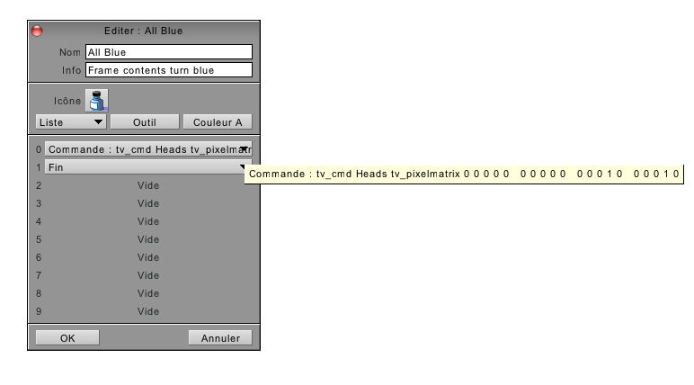

Sorry but , if I understand well, what Karina asks is how to change the color of one the ink bottles at the sketch panel keeping all along the way it works. So she could change the outlines (if they are isolated in one layer) of all the animation at once. I suppose one could just change the color code in the script...
Of course she could use the FX panel too (FX Color/Change color or curves) but it would be more fuss.
But, Fabrice, could you explain your proposal with more detail, please?
Thanks
