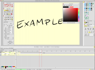

When previewing (with camera view) I can't see the entire canvas, because it stretches my project to fit the project window and my panels are in the way.
When drawing I can see the entire canvas.

Re: Trouble when previewing a project with multiple clips
Oh, okay, I got it !
Unfortunately, you cannot play the animation in a resized canvas.
Anyway, you can use F11 to play your video without losing your configuration. :)
