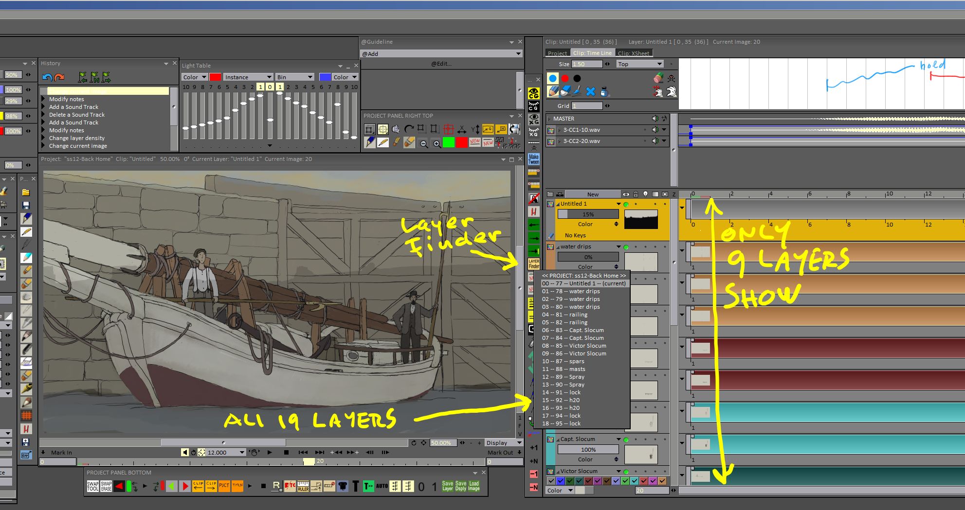

Another thing I forgot to mention was that while having two or more projects opened and switching between these, the Layer Finder automatically reflects each project's layers without having to do anything with it.

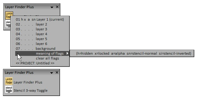

NEW: Layer Finder Plus - a few more features
Here's an updated version of Layer Finder that provides three more helpful flags for all layers showing all settings which the user may have chosen in the timeline layer headers. A new option lets the user clear all layers' flags with one click.
In addition I'm including another button which lets you toggle between pixel-stencil states: on-normal, on-inverted and off.
Like the first version, click any other layer to make it current - the timeline is forced to select and display the new current layer. Click outside the menu to leave things as they are.
Any problems... post here.
Layer Finder Plus.png (79.26 KiB) Viewed 7651 times
LayerFinderPlus.tvpx
(112.5 KiB) Downloaded 588 times
