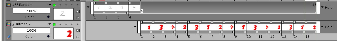

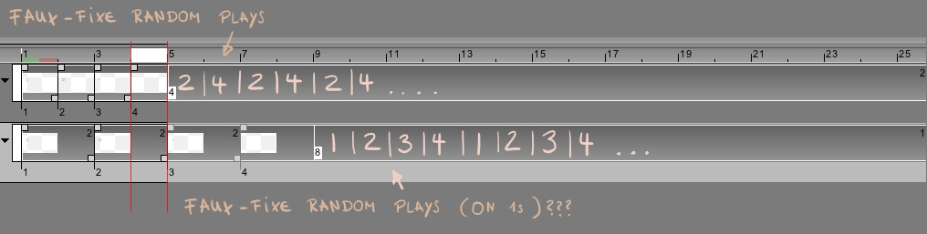

I have a sequence on 2s and want to use the faux-fixe random option, but it is not working properly.
When I set the faux-fixe on "repeat" or "ping-pong" everything works fine but on random the sequence plays on 1s and not random at all. I had this problem many times now and usually just rearranged the frames manually.
What am I doing wrong?
OSX 10.7.5 TVpaint 10.0.18 standard 32bit
I have attached a screenshot of a recreated timeline. In both cases the "random" option is activated and not working properly.

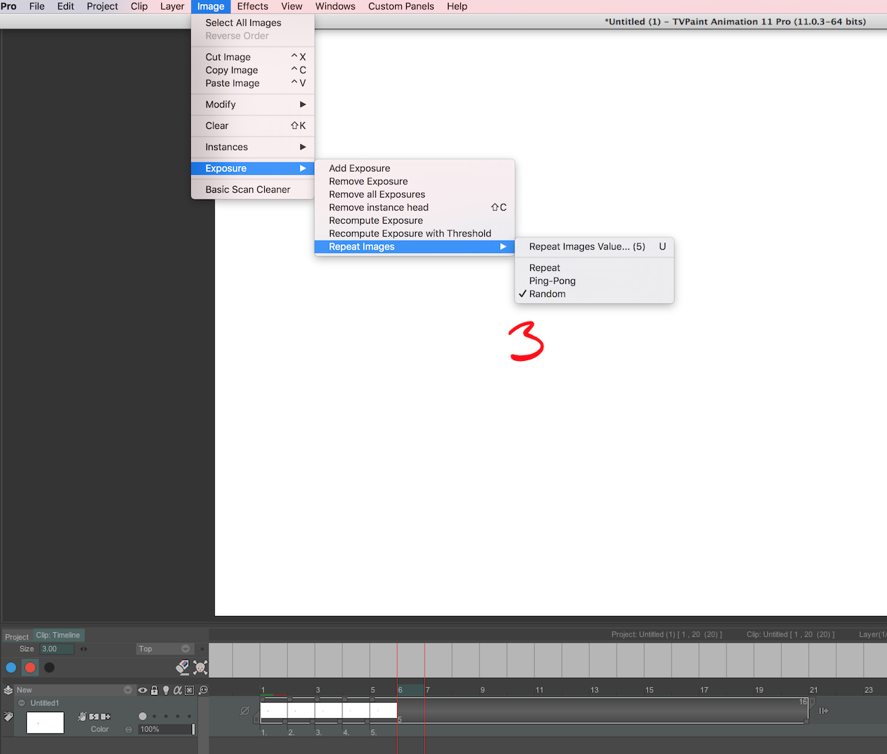

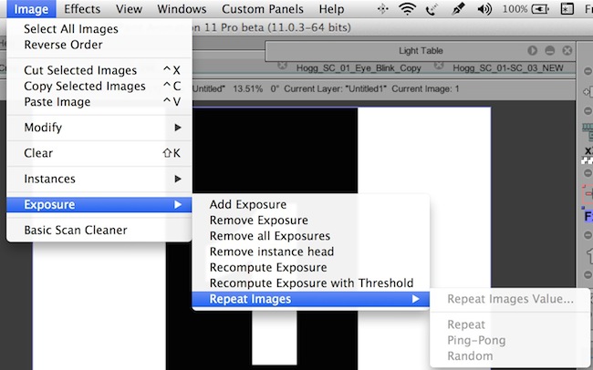

Can this be fixed for Mac ? In TVPaint 11.0.3 the Repeat Images - Random is greyed-out , not functional. Did this issue fall off the "to fix" list ?
http://www.tvpaint.com/doc/tvp11/index. ... eat-images" onclick="window.open(this.href);return false;
Repeat images Random not working on Mac.jpg (71.67 KiB) Viewed 29037 times
Does anyone know if there a way of creating a custom script that will apply the Repeat Images - Random command ? (or has someone already made such a script/custom panel?)
This would be very helpful for a project I'm working on now. When the character's Hold they don't come to a dead stop , but the hold is a five drawing trace-back cycle (to keep the line slightly alive/"breathing") . To keep the five drawing cycle from becoming apparent on a longer hold I need the five drawing traceback cycle to be repeated randomly.
Thanks.

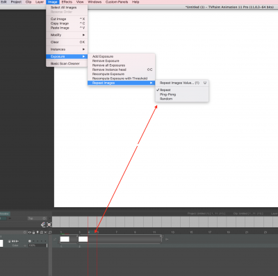

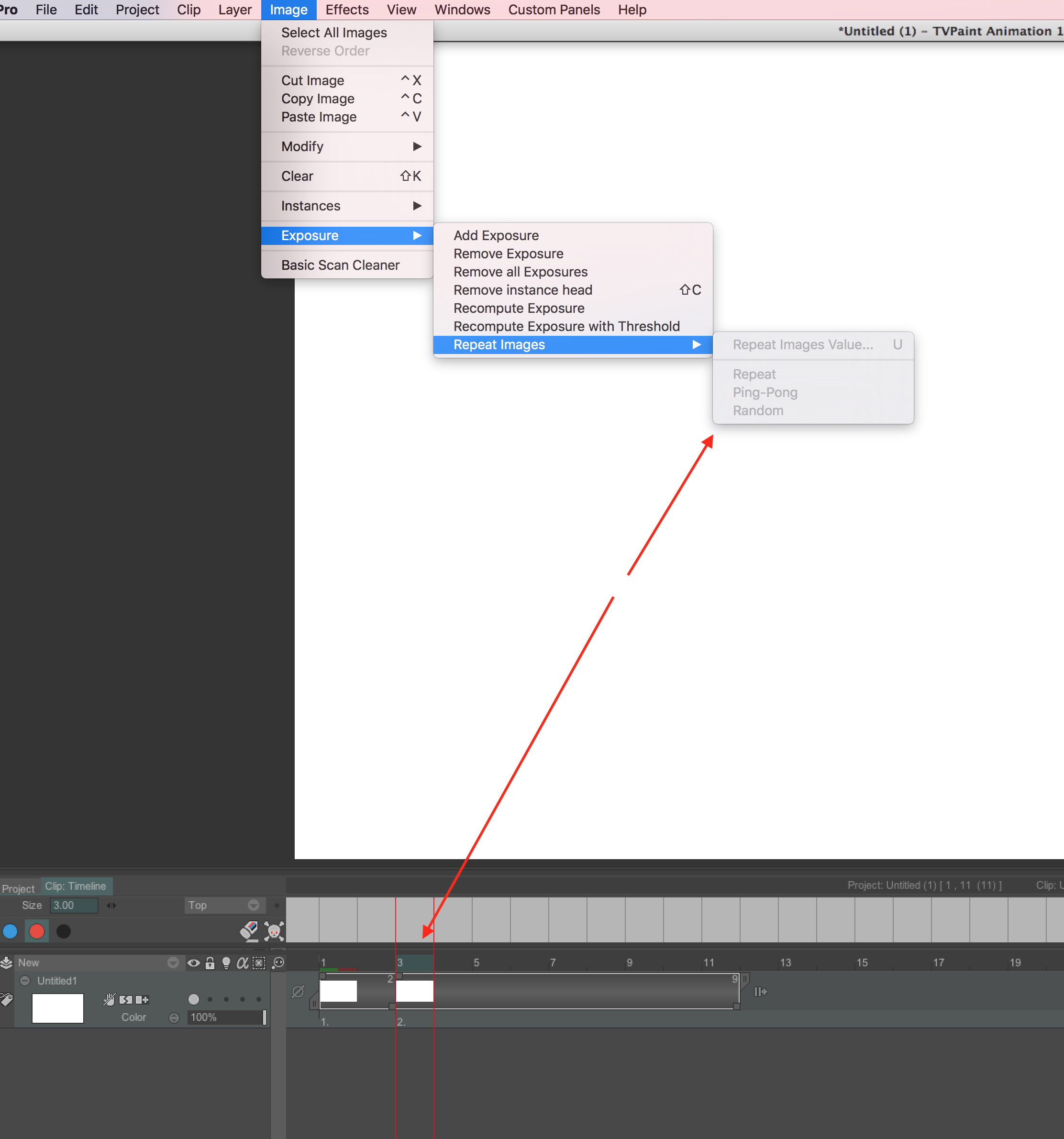

That's interesting that the options for Repeat Image - Repeat , Ping-Pong, Random are not greyed-out on yours running on MAC OS 10.11.5 ... for me running TVPaint 11.0.3 on MAC OS 10.9.5 the options are greyed-out (and the options have been greyed-out on previous version of TVPaint 10.5.7 ) .
I guess it's not a huge problem as far as the "Random" exposure ... if it's just a short section of 5 - to - 12 drawings that need to be cycled with random exposure I rearrange (copy & paste) the frames into a random cycle manually and then copy & paste the random cycle on the Timeline as many times as is needed , but a functional Repeat Images - Random command would be useful.
Repeat Images options greyed-out.jpg (71.21 KiB) Viewed 28974 times

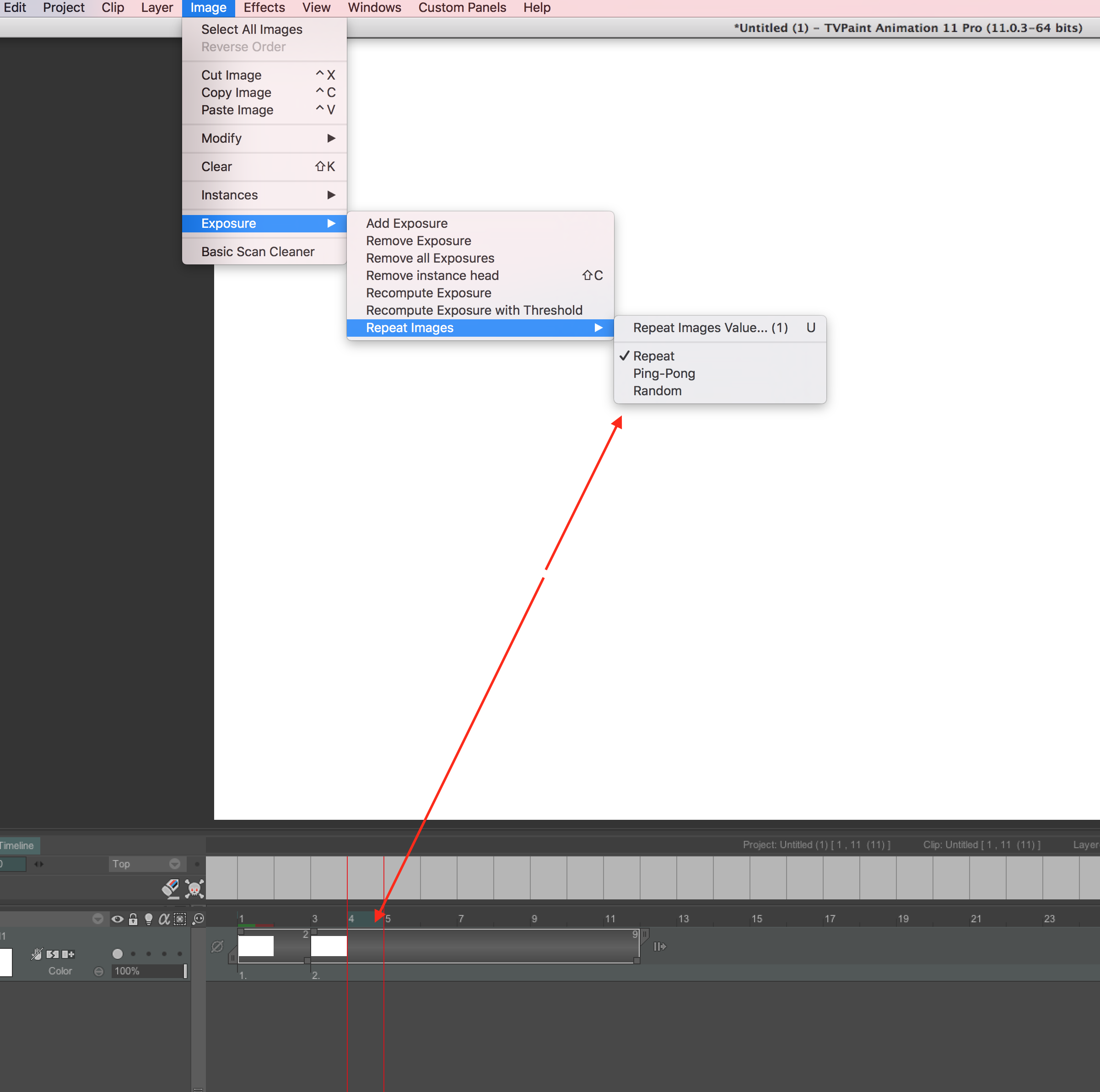

This might be silly but what are you on in the timeline when you try this?
It is only greyed out when you are on an instance.
See here:
Re: Faux-Fixe Random
furushil wrote:This might be silly but what are you on in the timeline when you try this?
See here:
YES ! That's it. Thank you ! I thought I had to have the Instances selected (like in applying an FX Stack or a Transformation) But if I move off the instances as shown in your screen shot the Repeat Images - Repeat - Ping-Pong - Random are no longer greyed-out . I had no clue ... it's really not clear in the User Manual about that little detail ... the User Manual does note it can not be applied the instance head and I missed that : "This is made possible by the Repeat Images Value option available in the timeline's contextual menu. That value is applied on the wished exposure cell (you cannot use that value on the instance's head)." Maybe I'm a dullard :oops: , not paying close enough attention , but the meaning was not clear to me in the User Manual, that I had to move off the instances entirely before attempting to apply Repeat Images - Random . Most of the time in TVPaint if I want to apply something it means that the instances must be selected (as in Apply FX Stack or Apply a Transformation , so this seems counter-intuitive to me from the way things are usually done in TVPaint ... ) Well, now I know ... Now the Repeat Images menu is not greyed-out , but sadly, as you mentioned before , the Repeat Images - Random function still does not work. :(
