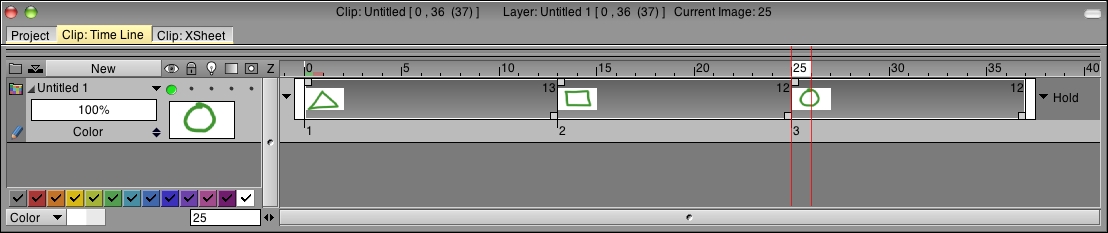

Let's imagine I have the "key" animation :
create instance N frame.jpg (92.14 KiB) Viewed 25613 times
I've selected all the frames and I use my magic button.
What is the result ?

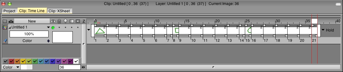

1) break the big instance into several instances of twos, but does not "detect" the next big instances, it just breaks every 2 frames :
2) break the big instance into several instances of twos, but "detects" the next big instances :
I think the 1'st option should be a default, and the 2'nd option - an option to choose. Would be great if they both were available.
