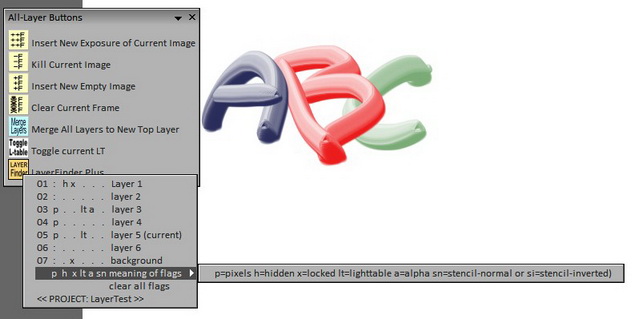

Here is a group of buttons (some old, some new or updated) that more or less deal with modifying layers.
All-Layer Buttons.jpg (44 KiB) Viewed 5166 times
What each button does:
the first four buttons act on the current frame for ALL layers
1. Inserts a new EXPOSURE of the current image (adds frame).
2. Kills the current image on all layers (removes).
3. Inserts new empty image on all layers (adds frame).
4. Clears the current image on all layers (erases) except locked or hidden layers.
5. Merge All Layers to a NEW TOP LAYER - combines all layers into a new layer with an option to BLEND or combine only those layers with the same color group as the current layer (The new merged layer defaults to hidden).
6. Toggle current LT - lets you toggle the LightTable of the current layer ON/OFF.
7. LayerFinder Plus button - update which now displays the status of ALL settings for each layer (added lt=LightTable for each layer and p=Pixels which indicates those layers which have pixels-images... layers with : (colon) instead of p are blank.)
As before, the clear all flags option will clear all flags/settings except of course those layers flagged with p (the pixels-images remain).
Feedback appreciated - report any problems, thanks!
Sven
