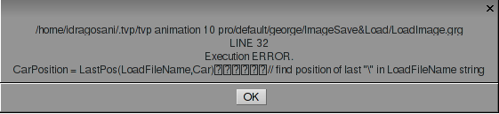

It works well on Linux, for saving and loading. However, these things to note:
1. I get a dialog popup telling me it created /home/idragosani/QuickSaveImages for every use, even if the directory was already created.
2. When I load an image, even though the image loads into the frame, I get this error dialog.
