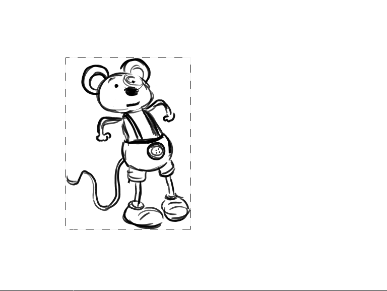

I woulld like a George Command wich could return the bounding box of an given image of a given layer in the current clip
So if I had a drawing like this:
And a george script like this

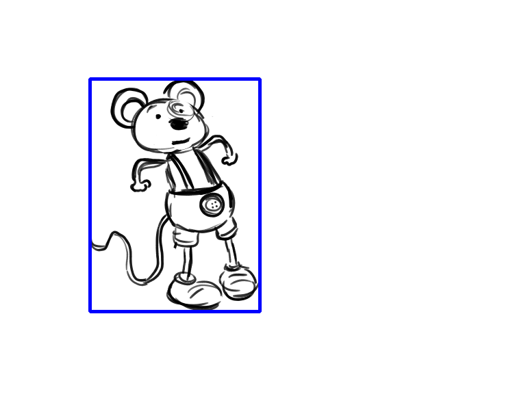

bound = result // Returns 131 115 379 455 with this image
tv_rect bound
Would produce his result
If I had a blue pen as selected tool
-Mads
