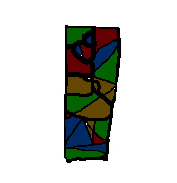

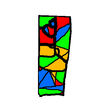

Hello. I want to find unpainted areas in TVPaint. See pictures below.
There are unpainted areas in this saturated color painting, but it's hard to find where it is.
So, I always use adjustment layer in Photoshop, threshold adjustment layer, and it makes it really easy to find unpainted areas.
Like this.
Threshold Adjustment Layer opacity = 70%
Threshold Adjustment Layer opacity =100%
I can find unpainted areas,white dots,thanks to adjustment layer, but there is no adjustment layer in TVPaint,
so I wanna ask, what do you think is the best way to find those unpainted areas in TVPaint?

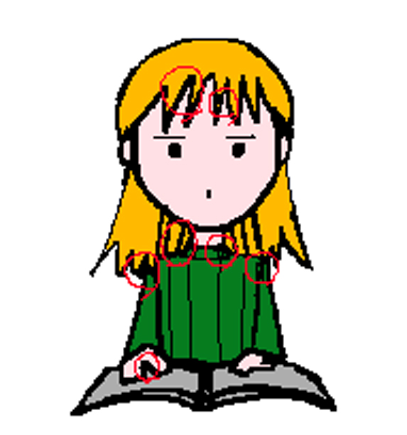

I thought it's good, but sorry. If I need to paint those kinda things, no.
There are holes, transparent areas. I draw red circle around them to make it much clear to see.
If I do invert-selection-painting, it means I can't find where the holes are, so I will paint inverted areas blindly using one color, like black in this case.
But,this is much better for me. I need to paint yellow on hair, dark green on clothes.
If I need to paint this simple drawing, it will be no problem, but If I need to paint much complicated things like colorful machine with lots of small parts,it will be bad. It will be nice if TVPaint has an option to darken opaque areas temporarily to paint. I thought it's possible because it has stencil display option, but seems not.
RETAS STUDIO has this option, and Toon Boom has an option called Black Light. Both darken opaque area temporarily. It's a drawback.

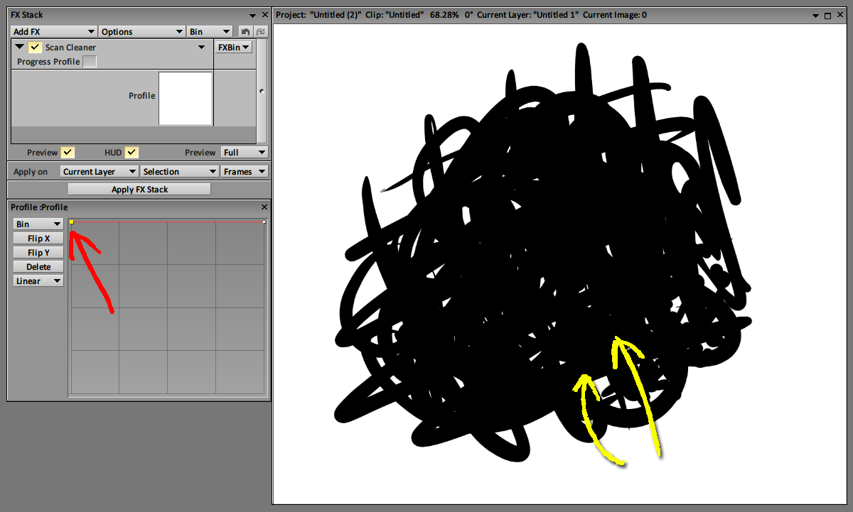

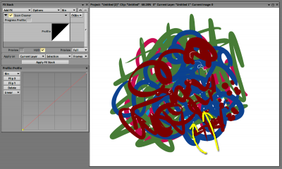

You can do this in TVP just fine, same way as you'd do it in Photoshop. Instead of making an adjustment layer, use the FX panel "Scan Cleaner." Then, adjust the control points so that everything is made black. This adjustment is based on alpha, not color, so it won't confuse white for transparent. You can show/hide the FX layer using preview or checking/unchecking the box next to it in the FX panel, similarly to how you might use an adjustment layer in Photoshop.
BEFORE:
In this screengrab, the yellow arrows are pointing to little patches of white, not clear.
AFTER:
In this screengrab, the red arrow points out the Scan Cleaner profile you must use. Note that the white areas indicated by the yellow arrows are now black, but the unpainted areas remain white, to show that they are clear.

Thank you neonnoodle. It works fine. It's really something like a threshold effect in Photoshop, but if fx preview is on, I can't paint. Can I assign shortcut key to toggling fx preview on and off?

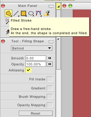

I also use the Filled Stroke tool set to Behind mode to make quick corrections to fill any noticeable gaps.
Filled Stroke Tool.png (28.27 KiB) Viewed 34638 times

The example image you posted :
makes me question your insistence on using non-anti-aliased lines to draw your characters . How does this make it better to click-and-fill easily using the Flood Fill tool ? The small areas between the jaggedy lines in the example you posted are harder to fill smoothly than if the lines had been drawn with anti-aliasing enabled .
What resolution are you working at ? The jaggedy lines makes it seem as if you are working at a very low-resolution. I'd suggest using at least 1280 (1280 x 720 for 16:9 aspect or 1280 x 960 for 4:3 aspect ratio ; you can downscale the images later if you want the final output to be smaller , but the larger resolution will give better line quality in the original project ) . Use the pen tool with Anti-Aliasing enabled and also consider enabling the Smoothing in the Shape Settings panel .

The example image you posted makes me question your insistence on using non-anti-aliased lines to draw your characters . How does this make it better to click-and-fill easily using the Flood Fill tool ?
Yes. It is not so good in TVPaint, but Celsys software has good filling functions which can fill little holes with one brush stroke.
I use their software usually, so such a little holes does not matter for me, but you are right.
I need to think about it if I use TVPaint.
And that girl picture is low-resolution picture. I usually make animation that is bigger than 1024x768.
But anti-aliasing isn't my choice, because my After Effects setting can't handle anti-aliased images well. In addition, I am not good at cleaning up line art using anti-aliased pen. I always use eraser tool over and over again in cleaning up process, and it makes lots of garbage, but aliased pen and eraser won't make sucha garbage so much because its alpha value is always 255.It can save lots of time.

Zetariver wrote:Thank you neonnoodle. It works fine. It's really something like a threshold effect in Photoshop, but if fx preview is on, I can't paint. Can I assign shortcut key to toggling fx preview on and off?
I think the easiest way to toggle the FX Preview on and off is simply to check and uncheck the preview box. The Scan Cleaner FX with the profile set to the parameters as shown will show the paint level in solid black, to reveal any unpainted gaps . Then uncheck the Preview box to enable being able to paint the gaps. (use the Filled Stroke tool set to Behind mode) .
