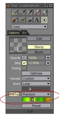

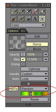

Posts: 4498
thanks to one of those stupid spambots
my attention came to this thread.
i must say i really want to support Asaf's point
it would be very usefull to have the animation connection work in the same way as the others.
though it might sound like a subtle control refinement it opens up an even larger world of possibilities
even if it would only be used for controlling color.
color is not really a part of the custombrush control
but you can influence it using the custombrush grey tones in combination with the 'Luma stamp' setting
now if we could also have a curve editor for animation (for instance in the random setting) you would be able to have controle over the colorvariation of your brush.
this is something currently NOT possible in tvpaint but it IS possible in Photoshop do we want this shamefull situation to remain? :wink:
but maybe it would be a better idea to look at the possibilities of adding a seperate color connection.
because it would also be real powerfull to have this with all the other tools.
(a long long time ago(dec 2003) i did some suggestions into this direction, see image, nice to see we have come a long way from that by the way)
about your remark on the average user... you are probably right but i think it is important to provide users with the best tools we can so we should simply built those for them and include them with the program, like before, and i don't mind building some (as you know)
