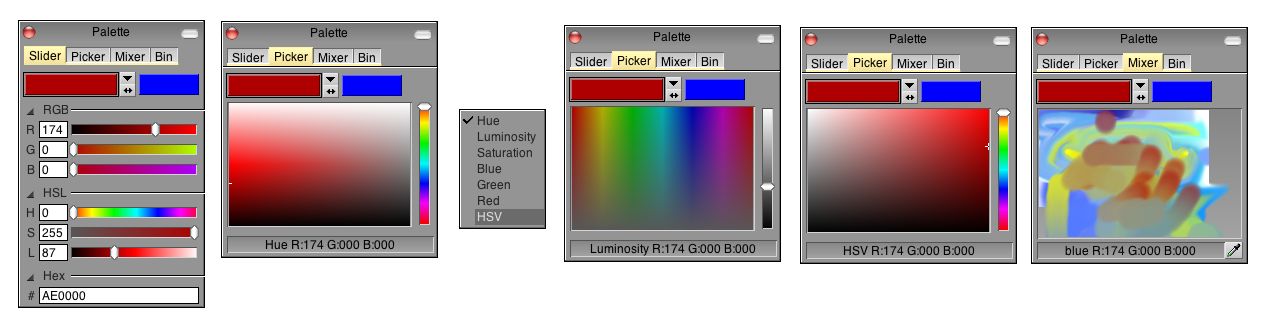

sharkcellar wrote:I don't like the color picker.
Could you explain more ?

Peter Wassink wrote:but then when you start to paint with the picked color it outputs a color that appears very different from the sampled one.
this has to do with how some custom paint tools use a combination of A and B color etc... of course once you know you can figure out ways to deal with it but... in the end... you cannot call it intuitive.
Sure, I agree : but the behavior you describe means 2 possibilities :
• you used some custom brushes from the tool bin (which are hidden by default).
or :
• you succeeded to create a custom brush with different colors / hues etc...
• you maybe modified the color mode and used the Alpha Diff mode
• you also changed the stamp mode of your custom brush and used, for example, the Luma mode
I mean, the problem you describe is true, but it means also you went deeper in the software to have this peculiar problem.
If you just try with a simple airbrush, the way you pick up colors to paint a gradient is not that different from Photoshop.
What do you propose to make thing easier ?
