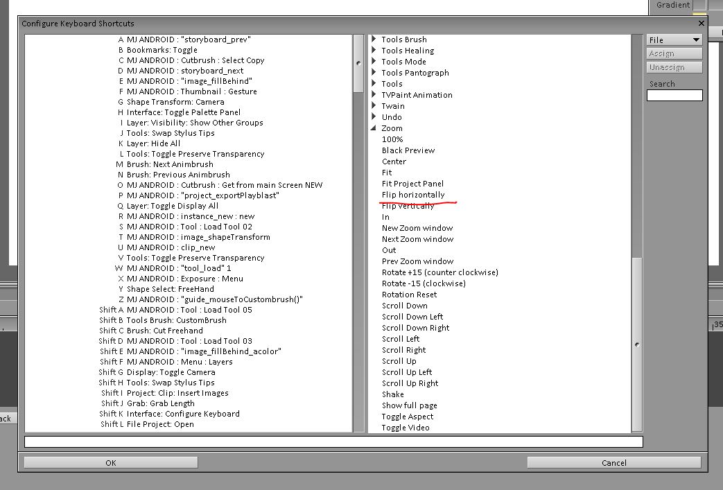

I have a custom action I created to do just this. In your custom panel, add an action and select add keystroke: then Image: then Flip Horizontally. Now whatever image will flip when you hit this new button you've created. You can flip it back with another press when you're done too.

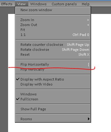

Sorry I misunderstood you. must have been tired
You can also flip the view in the menu view>Flip Horizontally keyboard shortcut ' ['
