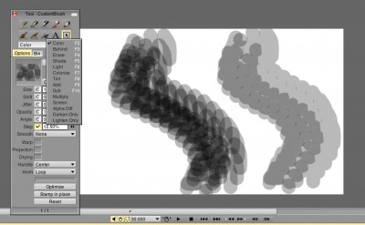

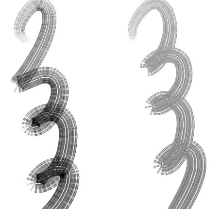

I submit two images for demonstration purposes and I would love it if anyone can help me get the "no buildup scratchies" line quality in TVP.
In the Plastic Animation Paper image, I show that the opacity does not multiply on itself, and you can see the nice, low-contrast (low boil in animation) result.
In the TVP example, perhaps I should have used a hard, circular airbrush for better comparison...but I used a version of Mark Chong's lovely Natural Sketch brush, which behaves exactly as I would hope across strokes, but within a stroke, it builds up. Even just drawing a strong angle (so that the dab crosses onto itself) creates an unsightly, unnatural looking buildup, which is a 'signature' in an animation context.

Super easy :David Meslin wrote:I submit two images for demonstration purposes and I would love it if anyone can help me get the "no buildup scratchies" line quality in TVP.
Try the "alpha max" setting in the custombrush panel.
It has been here since 4~5 years, specially created to answer Hisko needs for his film Junkyard. (http://vimeo.com/84024649" onclick="window.open(this.href);return false;)
- AlphaStampMax.jpg (25.15 KiB) Viewed 32778 times
