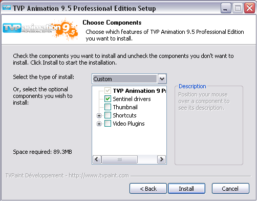

if you still have the tvpa install file, you can execute it,
and check the Sentinel driver option if you're in custom mode.

So, I suppose I didn't check the Sentinel Drivers check box, as in above? When does that screen pop up? I didn't see that screen when I loaded the program onto my computer....how do I find it?

chrisheadrick wrote:... When does that screen pop up? I didn't see that screen when I loaded the program onto my computer....how do I find it?
Wizard setup ... [Next] / licence Agreement ... [Next] /Choose Install location ... [Next] / Choose Components (here you are),
just before the last clic on [Install], you can't miss it.
