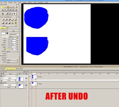

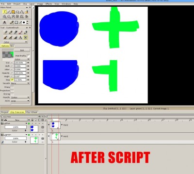

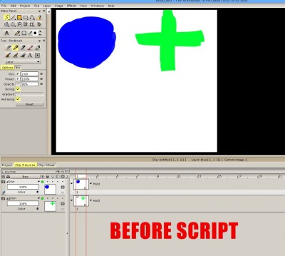

Here is my Project before the scipt. I have a layer with a blue Cirkle and A layer with a green add sign
Then I run my script. And the part of each layers in the "getBound" is copied to the "setBound"
But when I press undo I get this
It should be the same as before the script of course, but the green add sign is dissapeared, and now I got blue circles on more layers.
Clearly not the disired effect of an undo ;)
