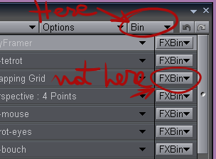

also, take care to :
- enable the FX before adding it in the stack bin,
- store the FX in the right bin, the one for the whole stack
(in the head menu-bar, (not those for individual FXs)
