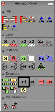

Select all your frames from a layer and use "+1" from the Animator panel, in the "exposure" part :
add1 expo.png (21.01 KiB) Viewed 23040 times

Because you can bind keyboard shortcuts to Custom Panel buttons, I have found it helpful for my setup to have +1 and -1 Exposure bound to the + and - keys on my number pad. That makes it quick to adjust timing with the keyboard only, since I frequently have difficulty on my tablet selecting the heads & tails of the instances.
