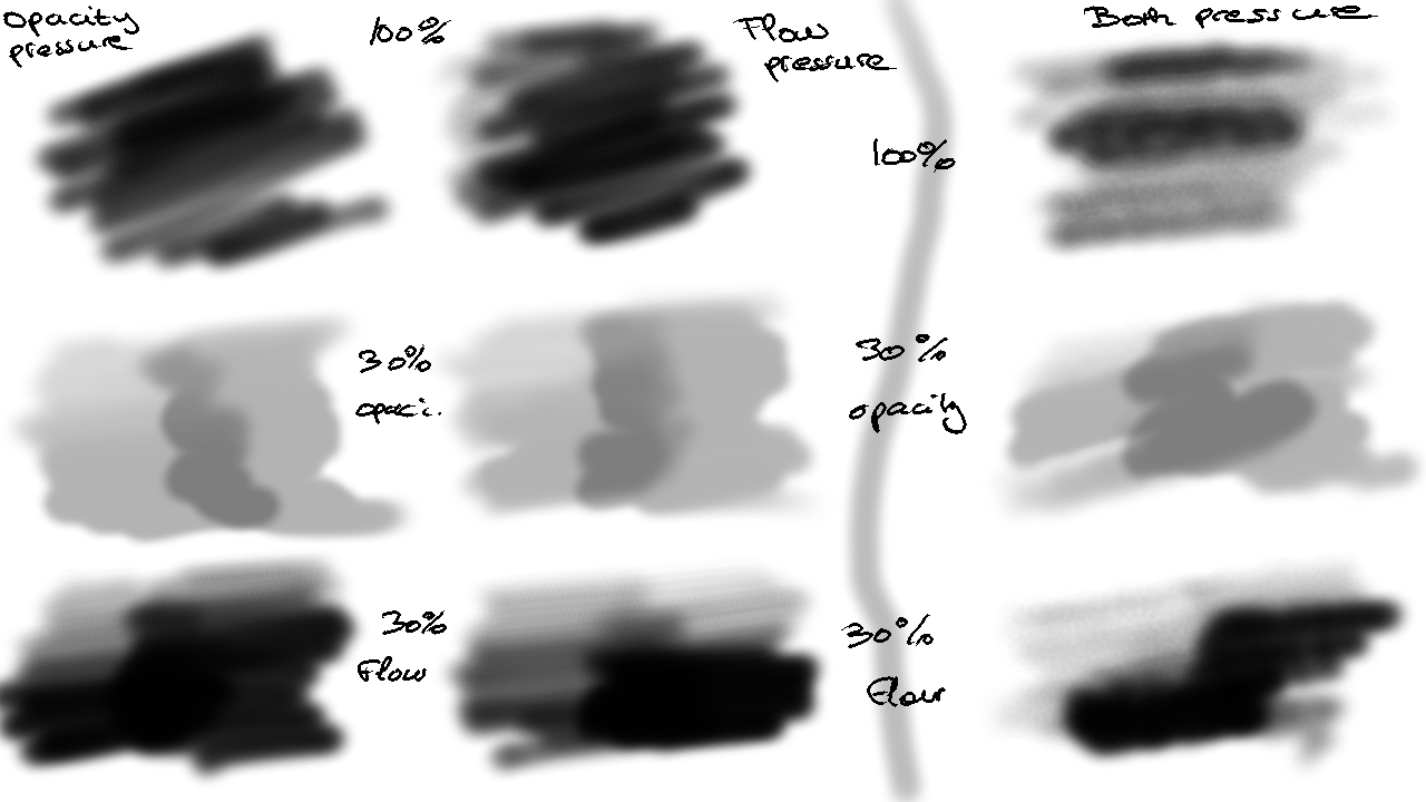

Re: Pressure sensitivity on brush Opacity
gbball wrote:Edit: I noticed, Elodie, that you mentioned it wouldn't make it into the next release, did you mean ver. 11?
Yes, I did.
We worked on applying pressure on opacity during several weeks in September, but results were not good and it definitely made no sense (contrary to Power or Size, Opacity is a max tolerance).
In other software, Opacity is named "Flow" and Power is named "Opacity". These software "can" use pressure on each parameter and even on both.
And actually, if you enable Pressure on Opacity or if you enable Pressure on Flow, the result is the same (see attached). If you enable pressure on both, then, you have a buggy result.
So, we dropped this improvement to focus on other ones.
