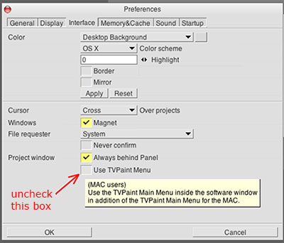

Speaking of making buttons, I notice a confusing error. The menu set in TVPaint should be replicated in the button editing panel, but it's not. So if I want to make a button which will, for instance, “remove instance head”, I would expect to find it in the same menu hierarchy as in the program. That is, Image/Exposure/Remove Instance Head. However, in the button edit panel it is hidden under Layer/Exposure/Delete Instance Head. It took some searching to find it there and so I wondered why it was not under the expected menu and even called a different thing (“delete” instead of “remove” instance head).
On the Mac, there is a double set of menus at the top. Not the end of the world, but a bit odd. When I go to full screen, however, that second menu set keeps popping down, obscuring the TVPaint menu, which is annoying. I’ve not seen this behaviour on any other program on the Mac. I think that's because on other programs, the menu disappears in full screen, but here, it stays so you get two menus.

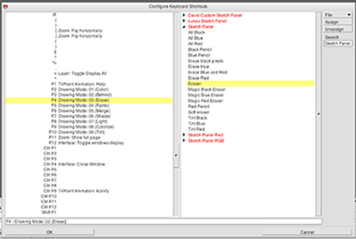

I'll let others jump in concerning your other suggestions, but here are a couple of comments on two of the things you are asking for:
You can do that (assign a keyboard command -- Erase -- to any brush ). By default the erase keyboard shortcut is F4 , but you can reassign that to another key in Preferences .
I program my Wacom stylus eraser end to keyboard command F4 = Erase . When I want to erase I flip the pen over -- just like I would with a real pencil -- and erase , then return to drawing .
David_Fine wrote: Speaking of the brush, a really fundamental thing I am used to in other graphics apps is the ability to very quickly change between my drawing tool and my eraser of choice. TVPaint won’t do this. I know it will quickly erase using the same pen I am drawing with, but if that pen is very fine or chalk like, it is not very useful as an eraser, so I need to change to my own predefined eraser, which involves multi clicks and moving the pen back and forth between the buttons. I would like to be able to make my own eraser and assign that to a button on my pen. That way, I could draw and erase without even lifting the pen from the screen, just as I can do in other graphic apps. Related to that, if I could assign a keyboard command to any brush, then the use of buttons on my pen would be limitless. That would be a great addition and, I think, pretty easy to fix.
You can get rid of that in Preferences. Uncheck the box next to Use TVPaint Menu under Preferences > Interface .David_Fine wrote:On the Mac, there is a double set of menus at the top. Not the end of the world, but a bit odd. When I go to full screen, however, that second menu set keeps popping down, obscuring the TVPaint menu, which is annoying. I’ve not seen this behaviour on any other program on the Mac. I think that's because on other programs, the menu disappears in full screen, but here, it stays so you get two menus.

Thank you for the quick reply. The pref to fix the menu is great. Didn't notice that, so thanks!
The eraser suggestion doesn't work though (unless I am misunderstanding) because, as I mentioned, it will only turn it into an eraser which is the exact same as the pen currently in use. That doesn't work for me when I am using a very fine pen or some kind of pen which does not work so well as an eraser. I want to be able to define a specific eraser to a key, which does not change depending on the drawing brush I am using. This is how Photoshop and Sketchbook do it. Is there a way to do that in TVPaint?

Regarding the eraser issue, have you tried this?; assign a keyboard shortcut to the eraser and then in the preference settings of your Wacom tablet assign that keyboard shortcut to the pen button of your choice.
EDIT: I just tested this on my Wacom. What happens is; the brush changes to the eraser, but doesn't switch back to the previous brush when I release the button. I see why this isn't very practical...
I find that new users often bring very insightful comments to the table when it comes to workflow issues in TVP. Things that more seasoned users have managed to find excuses and workarounds for that are necessary but often not most efficient. So by all means, keep posting your opinions and suggestions.

the erase issue was also discussed here:
http://forum.tvpaint.com/viewtopic.php? ... =15#p72517" onclick="window.open(this.href);return false;
The conclusion there was that you can have what you ask by assigning "eraser" to the rocker switch in the wacom panel.
but at the cost of losing RMB function in that switch, which among other things is often used for zooming, or erasing in filled strike mode.
But this problem in turn can be worked round by aplying the space bar, which is set as RMB.
Not ideal, but it might work for you.

I forgot to mention the thread that Peter Wassink referred to in his post :David_Fine wrote:Thank you for the quick reply. The pref to fix the menu is great. Didn't notice that, so thanks!
That has some other options.
One other thing I forgot to mention (because I just do it from habit) is if you use the standard Wacom stylus setting of the eraser end of the pen set to "Erase" the default size of the eraser will be 5.00 , BUT if you change it to a larger size , say 20.00 , it will retain that size every time you use it within the current project session. (unfortunately it defaults back to 5.00 if you quit and restart TVPaint, but very easy to reset it to larger size when you start a new TVPaint session)
Most of the time if I need the eraser to be larger than the default 5.00 I just press the Z key to zoom the size of the eraser tool up or down as needed. (or program one of the Wacom express keys to Z to activate the zoom tool size).
