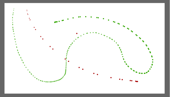

Regarding the lag, we discovered that there is probably an issue with the Wacom drivers as they don't send all of the informations. This is a regular issue happening wich each new version of Mac OS X. This also happened in Photoshop, ArtRage and Painter.
Capture d’écran 2014-11-04 à 11.png (26.1 KiB) Viewed 60144 times
In the screenshot above, the green dots are the result of a slow drawing stroke, and the red ones are the result of a fast drawing stroke.
You can see that some red points are missing.
This should be solved in the next release of Wacom drivers.

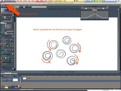

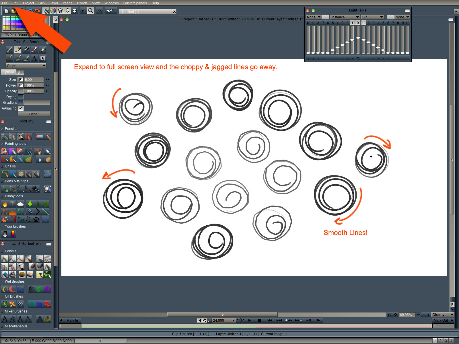

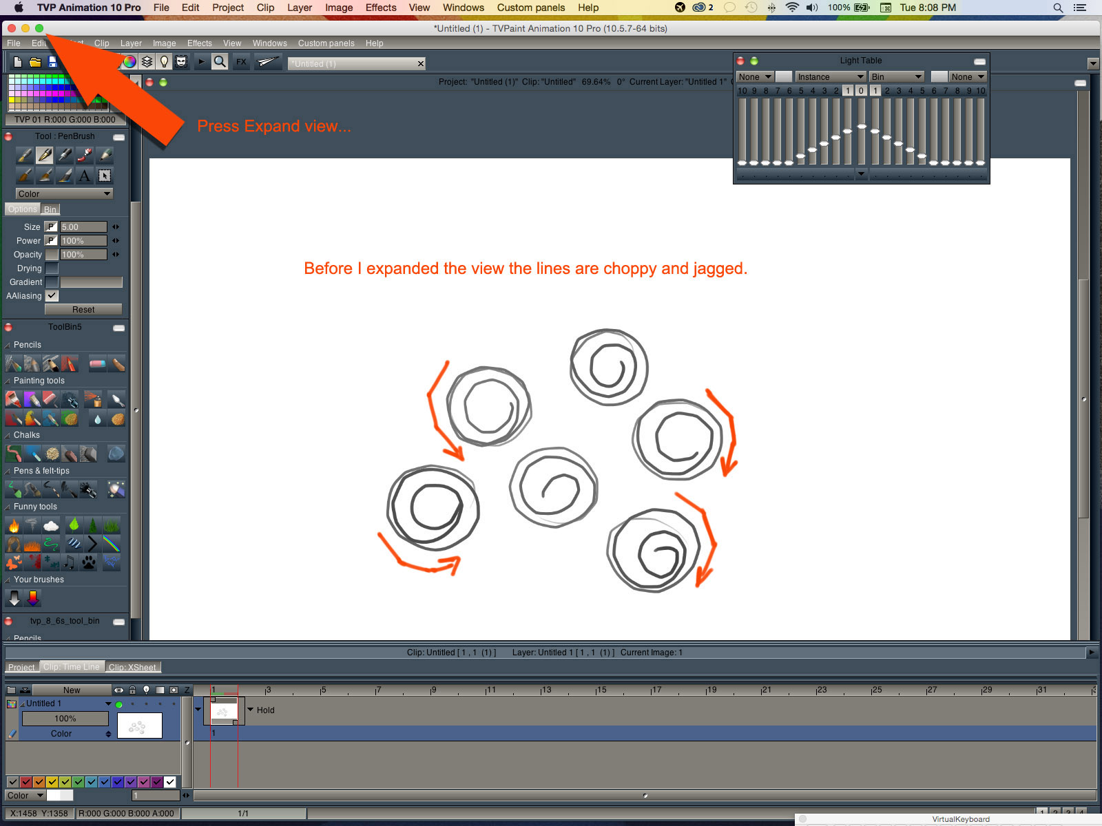

I've been experimenting with why my lines were jagged and choppy with the Yosemite upgrade. I learned that if I expanded to full screen on my Mac the lines became smooth again. ( Press the green button on top corner of the program. ) I've attached some examples and hope this helps. THX
Re: Mac OS X 10.10 Yosemite and TVPaint Animation
Very interesting ! Thanks. :D
Thierry will check this as soon as possible.
Thank you fo this interesting feedback !
