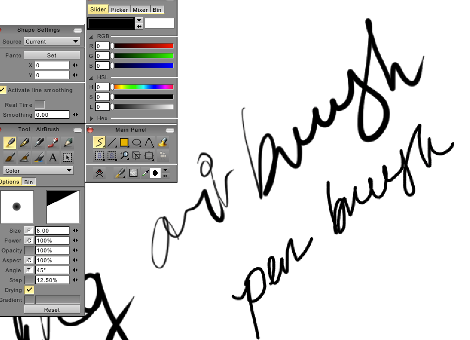

thank you! I am using TV Paint 10.5, OSX 10.9.4... I will definitely be colouring on a separate layer from now on! I prefer the varied weight of the tiny air brush... and find that even when I use a pen tool the pixelating is still happening. I have attached an image showing the pixelating on just the line, with both pen (with AA = on) and airbrush (with the settings I have been using).
- Screen Shot 2014-10-30 at 10.52.17 am.png (109.83 KiB) Viewed 22344 times

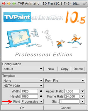

is your project maybe set to field: upper/lower ?
It should always be set to Progressive
Re: pixelated lines
Peter beat me to it. I was going to say the same thing .Peter Wassink wrote:is your project maybe set to field: upper/lower ?
In the Startup Panel, make sure that Field is set to Progressive . (not upper first or lower first)
- Posts: 3
- Joined: 29 Oct 2014, 03:30
Re: pixelated lines
Hi thanks yes it is already set to progressive.

what was your pen settings ? ... and how much your grabbed view is zoomed in your picture ?
I mean the "pixilating" lines could be on the screen (specially when the preview isn't exactly at 100%, or rotated),
but not in the exported file .
btw, why do you activate the smoothing feature, but with a "0" amount ...?
if you don't want any line smoothing, it would be better to check it OFF.
