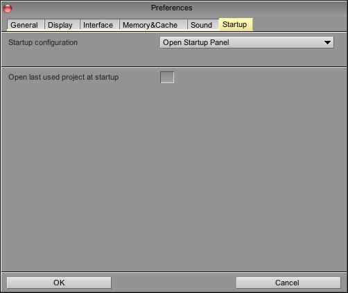

You can access the startup panel via this option in the Preferences panel :

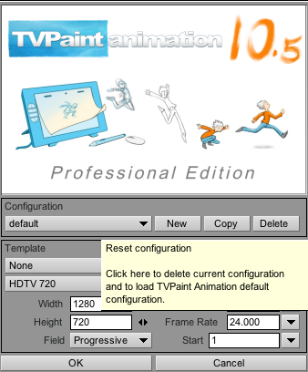

Then quit TVPaint and restart it. This panel should open :
To reset your configuration, simply click "delete" (this will erase your entire configuration)
