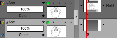

Periodically, I find that an instance on a layer is missing the handles that I need to drag it longer. The tiny box at the top left and bottom right. Here is a screen grab which shows this. Two layers. Bottom one has no handles. The top one is a new layer I made. I grabbed a brush from the other layer and pasted it on that new layer. It has handles. So now I can delete the other layer, but why do I have to do this? Why are the handles not there? What does it mean? Is Santa Claus real, or are my parents lying to me about that?

The bottom one is a so called image layer designed mostly for backgrounds -- the entire layer is the "frame" and is not possible to break into. But it can be changed at any point into an anima layer using the command Layer: Make Anim.

I see, but why do I ever need an "image layer" and why does it happen without me asking for it? Can't a background sit just as happily on a normal layer? How can I avoid a layer being this and how can I tell it is, apart from the missing handles?

I still fail to see the difference between an anim layer and an image layer. The points made about an image layer being layer wide are the same with an anim layer. Make one image on an anim layer, put it on hold and anything you draw on that image will be seen right across the entire time line. I do agree that the bigger handles for dragging are useful though. I asked about improving those tiny boxes (Fingers crossed for PT 11). Anyway, maybe I am still missing something or maybe I can just not worry about it anyway.
