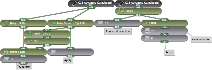

And I use a Logitech G13 gaming keyboard, cause I'm a bit nerdy about gadgets which seems to make my workflow faster or easier. That thing isn't necessary, but the reason my image shows the buttons G21 and G22.
However let's say I got the selection tool on SHIFT+CNTRL+f and the transform tool on CTRL+t. Then I used controllermate to set it up that I press G22 to make my selection and press G21 to transform. Double tap G21 to apply. If I press G22 again it clears the selection and toggles to the brush again.
My setup seems pretty complex for such an easy task, especially if you never used controllermate, but at least for me it seems to be the simplest outcome I can image at the moment.
