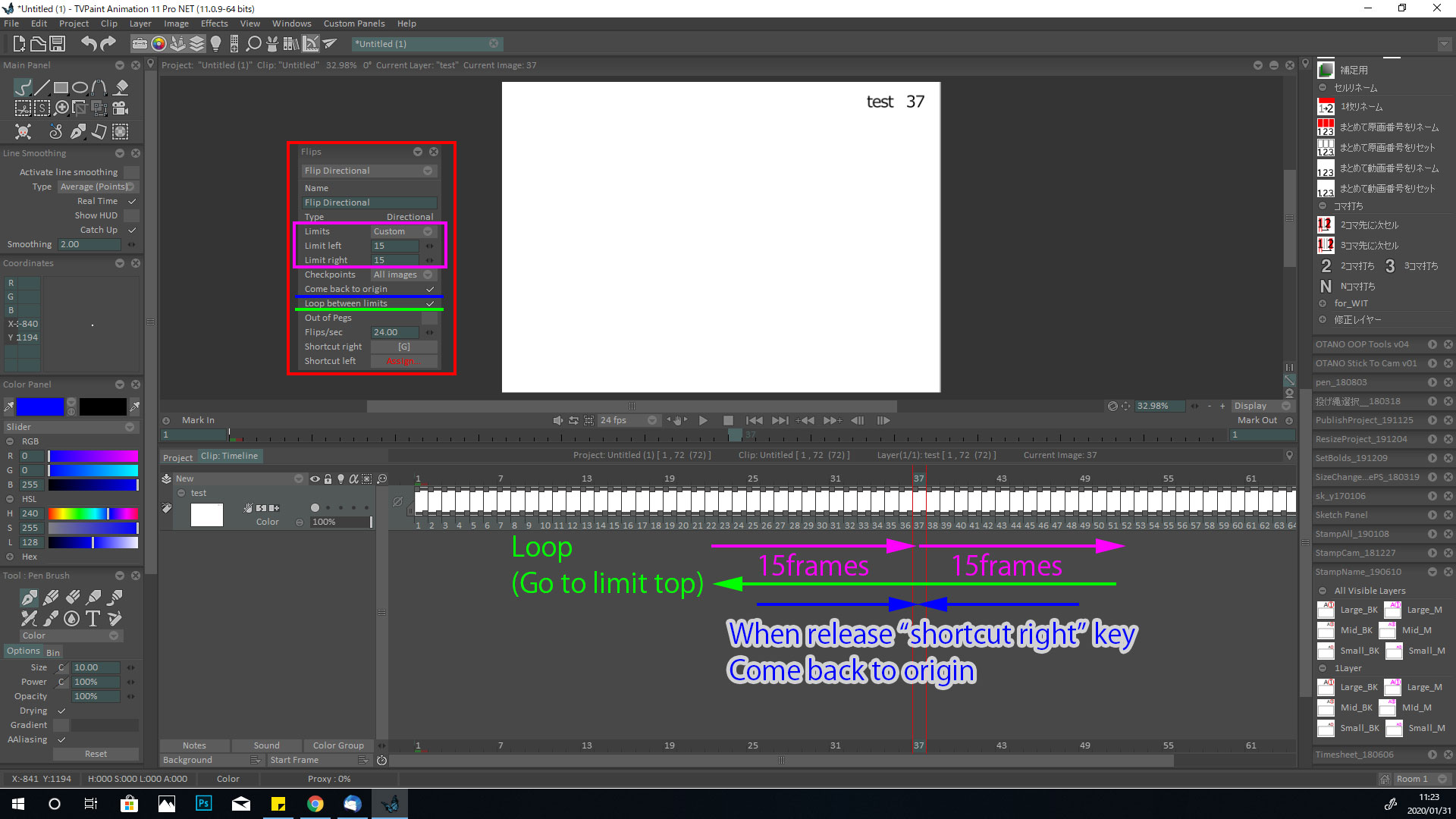

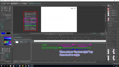

Hi! im using tvpaint 11.0.9
and i wanna know if there is any way to set the flipbook this way: by pressing a key, plays automaticly (at the frame rate on the remote control) 15 frames (aprox) pre and post the frame where i stand.
the "flip basic" do a ping pong, and i just want to be a loop play.
i can use the mark in and mark out. but it would be much faster and useful to me if the flip key work that way.
thanks!
Hironori Takagi
Posts: 292
Joined: 14 May 2018, 10:15
Location: Tokyo, Japan
Re: Is there a flipbook shortcut key?
Post by Hironori Takagi »
Please try the attached method.
・Use Flip Directional with Limits:Custom / check Come back to origin / check Loop between limits
