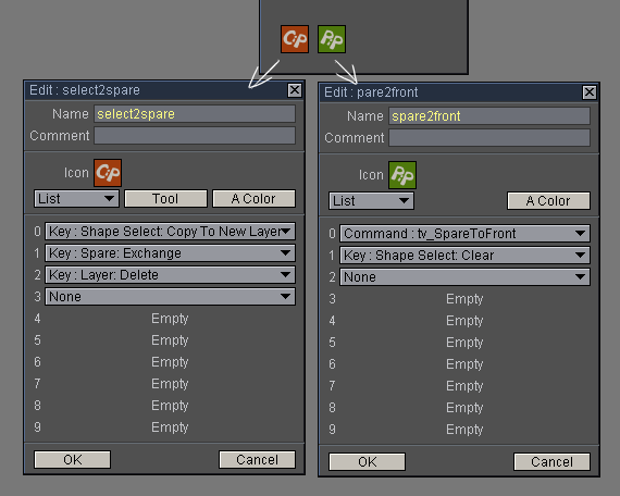

I personnaly use the copy/cut selection tools (instead of copy/cut brush tools)
to achieve a "paste in place" operation.
you can make yourself 2 custom buttons, one to copy, the other to paste, (see pict.)
how to use them :
- a) first "define" (surround) the part of the drawing you want to copy/paste,
by using one of the selection tools (f.i. the freehand selection tool),
- b) click the "select2spare" button (or use a shortcut),
- c) go to the frame where you want to paste (in the same layer, or in an other layer),
- d) click the "spare2front" button (or use a shortcut), that's all.
you can repeat c) and d) if you want to paste the same part into different frames.
