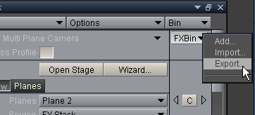

David_Fine wrote:... how do I save it? There is a Bin menu button and a FXBin menu button. In both, you can Export. Is that how you save a move and if so, which one to use?
FXbin/export ... will save the corresponding FX in its own file, a xxxx.bin file saved where you want on your HD (file path indicated in the export panel),
you can save it by FXbin/Add as well, but here, the FXbin will be stored in the tvpa config file, so you will be able to get it back the next time you will launch TVPA.
Bin/export ... will save all the FX stack (multiple FXs in one xxxx.bin file).

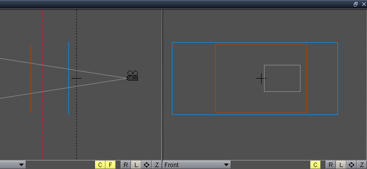

David_Fine wrote:... Also, once the move is done, I may have zoomed in on a layer. How do I figure out the resolution I need to draw that layer so that it is still good at it’s zoomed in size? Do I just guess, or is there some way of TVPaint telling me?
not exactly to guess, but to calculate (roughly estimate) it, (unfortunately, afaik, tvpa don't tell us the factor to enlarge the working project),
in the stage below f.i., at its max. zoomed step, the camera-field/background ratio is around 2.5, so the project size should be about 2.5x larger than the output size,
in the same way, the overlay* (panning) layer's length should be long enough regarding the panning length you will apply.
(* the blue one in my example, imported in the MultiPlane_FX from a secondary open project).
