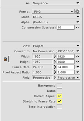

I have a student who is using TVPaint to make his thesis film , but his time is running short and he needs to enlist help from others to help color his characters. (since this is relatively easy click & fill work that can be passed off to others, allowing him to concentrate on animating ) He can not afford to purchase additional licenses of TVPaint for his helpers and the other people who have agreed to help him color already have Photoshop ... so , he wants to export cleaned-up line art from TVPaint as PNG image sequences (with transparency) so those image sequences can be imported to Photoshop for flood fill coloring by his helpers, then he will re-import the colored PNG image sequences to TVPaint to composite with his Backgrounds and add camera moves.
What are the best settings for him to use when exporting line art from TVPaint as a PNG image sequence to be flood-fill colored in Photoshop ?
Based on some searching around in the forum I believe these settings would be correct for exporting PNG image sequences with transparency :
Export As > Sequence
Format > PNG
Mode > RGBA
Alpha > Premultiply
Compression > lossless (10)
Resolution 1920 x 1080
Uncheck Background
OR should he export the line art from TVPaint Export tab Clips Layers Structure as .PSD format ?
Saving the colored images from Photoshop should he save those as .PNG (any particular settings from Photoshop ?) or save the colored images as .PSD format to re-import the images back into TVPaint ?

Re: Export PNG Image Sequence with Transparency
Posted: 04 Mar 2015, 23:52
by schwarzgrau
I just can speak for myself, but before TVP11 I used exactly this process and settings to color my drawings. So to me it looks fine.
If your student uses TVP11 he should maybe try the "Export All Images and Layers into Folders"-button in the "Handy Custom Panel" under "Miscellaneous", it makes the whole process maybe a tiny bit faster.
Posted: 05 Mar 2015, 07:01
by CartoonMonkey
Use those exact same settings you had.
PNG, not PSD. RGBA, background unchecked, but alpha NOT premultiplied,
believe it or not. That way you get the nicest quality png's and the alphas / colors will be correct.
Posted: 05 Mar 2015, 12:03
by D.T. Nethery
Thank you schwarzgrau and CartoonMonkey .
Posted: 05 Mar 2015, 12:17
by schwarzgrau
You're welcome and sorry, CartoonMonkey is right, I always get confused with the pre-multiply settings. That's one of the reasons this new button comes in pretty handy.

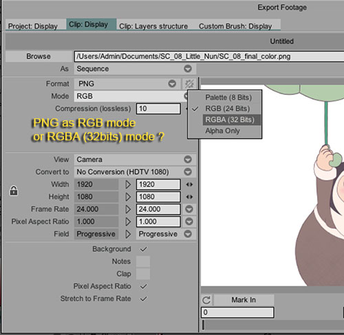

Paul, I wanted to ask you about what you said regarding exporting to PNG image sequence:
Paul Fierlinger wrote: But when it comes to client delivery I always convert all my TVP clips directly to PNG image sequences instead of making the conversion in Vegas. I once had a filmout conversion lab test the two results; PNGs from Vegas and PNGs directly from TVP and was told that the TVP pngs were superior to the Vegas ones.
When you export directly to PNG image sequence do you prefer to set the PNG to RGB (24 bits) or RGBA (32bits) ?
