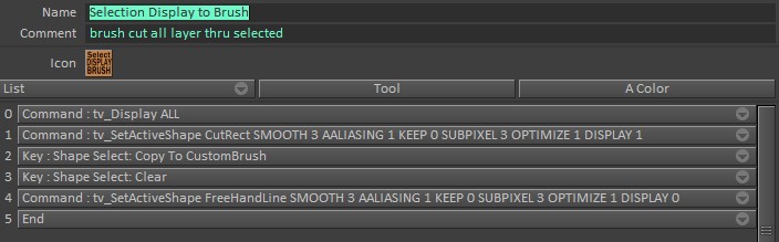

Posts: 1579
Re: Setting CutBrush operation parameters with GEORGE
NathanOtano wrote:Sorry, I was meaning with george. I found the brushcut function but it cuts without looking at the selection so I guess it's not possible.
The two GEORGE commands that Mike revealed DO let you set parameter values as needed to capture cutbrushes or animbrushes that respect SELECTED AREAS. In fact, it is possible to capture selected, non-contiguous areas of an image to a brush (or capture from multiple-layers into a brush as shown below!) something that the standard cutbrush commands don't themselves permit. Wonderful possibilities here.
cutbrush of selected area(s) and layers.jpg (34.26 KiB) Viewed 3622 times
Sven

Posts: 1579
You're right.
The button command, Shape Select:Copy To CutBrush respects existing select areas and copies only those selected parts of the image into the CutBrush.
The tv_BrushCut command in George still ignores the select areas and instead, always grabs the whole frame (current layer or total Display). It would be VERY HELPFUL if tv_BrushCut in George was updated to respect existing select areas like the Shape Select:Copy To CutBrush button command now does. That would permit a single-toggle-button George script like you're trying to write. :?
To work now with this limitation, I've had to setup two buttons: the first gives me the select tool... while the second (as posted) captures the selected area into the CutBrush and then clears the selection.
sven
