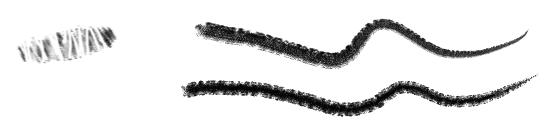

Okay, I've come out from under my desk. Yes, a little surly, but having said that, Slowtiger is correct. I overlooked that because it's under the category "angle", which I thought only referred to the angle of the brush, not animating the angle, but of course there it is, a "random" option, so thanks for pointing that out. Only thing is, if I bring the brush image into TVPaint from Sketchbook and pick it up and then use random rotate, I don't get the same result as in Sketchbook. In this picture, the top line is from Sketchbook and the bottom line is from TVPaint. You can also see the brush itself on the left. The top one is more appealing to me because it has more variation. I think this is because the brush options in Sketchbook allow for more adjustments. See the panel below which includes the degree of randomness rather than just on or off. Any idea how to replicate that Sketchbook type of brush better than I have here?

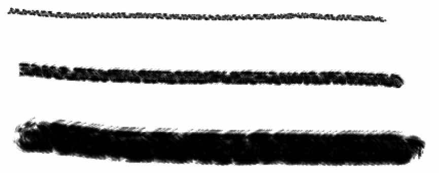

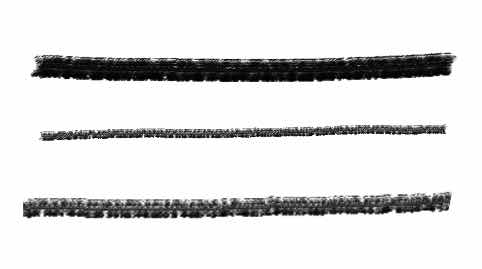

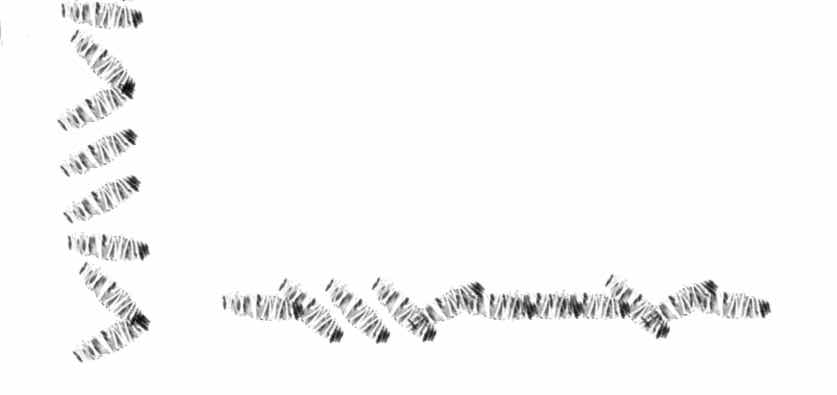

Also, I realize that a big problem with the brush is that it is not acting the way it does in Sketchbook in terms of orientation. In the pictures you can see that I purposefully stepped the brush so that we can see the elements. Drawing up or down uses the anim brush so that it is rotating in a distinct way, so that the dark end is always on the right side. (The anim is made of just 3 positions, in this case). Drawing left to write, however, treats the brush very differently and changes the characteristic of the line in a significant way so that the brush is painted lying completely flat. I want it to maintain the same use of the pattern no matter which way I draw. How can I do that?
Also, as in the next picture, the top line is the brush, the middle line is the brush reduced in size, which changes it's look considerably. The bottom line is the middle line blown up to about the same size as the top line so that you can see how different the line is. Why does this happen? If I resize the brush, I want to be identical, just smaller. Is that possible?

Re: Creating a brush question
I've fiddled around with it:
It looks somewhat like your Sketchbook brush but it loses a bit of it's character when the size is reduced, though. Also I couldn't get the opacity right where it tapers off at the end, there where it is thinnest.
I think you got the most out of this current still brush Michael, if you'd want to take it further you could try experimenting with an animated version of it.
i mean animating the stripe pattern, not the rotation.
One suggestion for the smaller (less then 100%) sizes of Michaels version, you can switch off the an"ti-aliasing" this makes the line less blurry, more gritty.

Thanks for this, Micheal. I will play with it. I am currently doing exactly what Peter suggests and making each brush stamp a little different to add more variety. My big question here is why does TVPaint change the characteristic of the brush so much when it is resized. Sketchbook does not do this at all. is there a setting which can fix this? It seems to me that some of the parameters do not reduce in proportion to the line size and so remain too large for a thinner line.
As I play with this, it feels like it is the stepping which does not size down, which is why the line gets lighter, because the steps for each stamp of the brush are fine when the brush is big, but when it is reduced, that step spacing stays the same amount apart, so proportionately further apart in a small brush, resulting in a lighter line because the stamping is not as dense. So is there a way to control the stamping steps in an anim brush to make it tighter? Leaving Step set at zero does not work. Here is an example which shows the same line at different sizes and I think you can clearly see that this is down to the stepping being dense when it is large and not as dense when it is small. The steps need to reduce with the brush, but how??
I think you make a good point there! Looking closely at the brushlines it seems to me that the stepping in relation to the size of the brush doesn't change when the brush increases/decreases in size. This probably explains why the TVP brush is less opaque and less sharp when it is at it's thinnest in my examples above.
