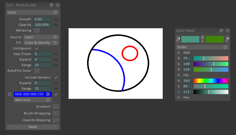

* A Contiguous option has been added to the paint bucket, selection: magic wand, cutting tool: magic wand (works like Photoshop), alongside with a Display checkbox in the selection: magic wand.

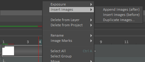

* The Break Instance option that was in TVPaint Animation 10's Animator Panel has been added to the Handy Panel (to have it, delete your Handy Panel, it will be recreated when you relaunch TVPaint).

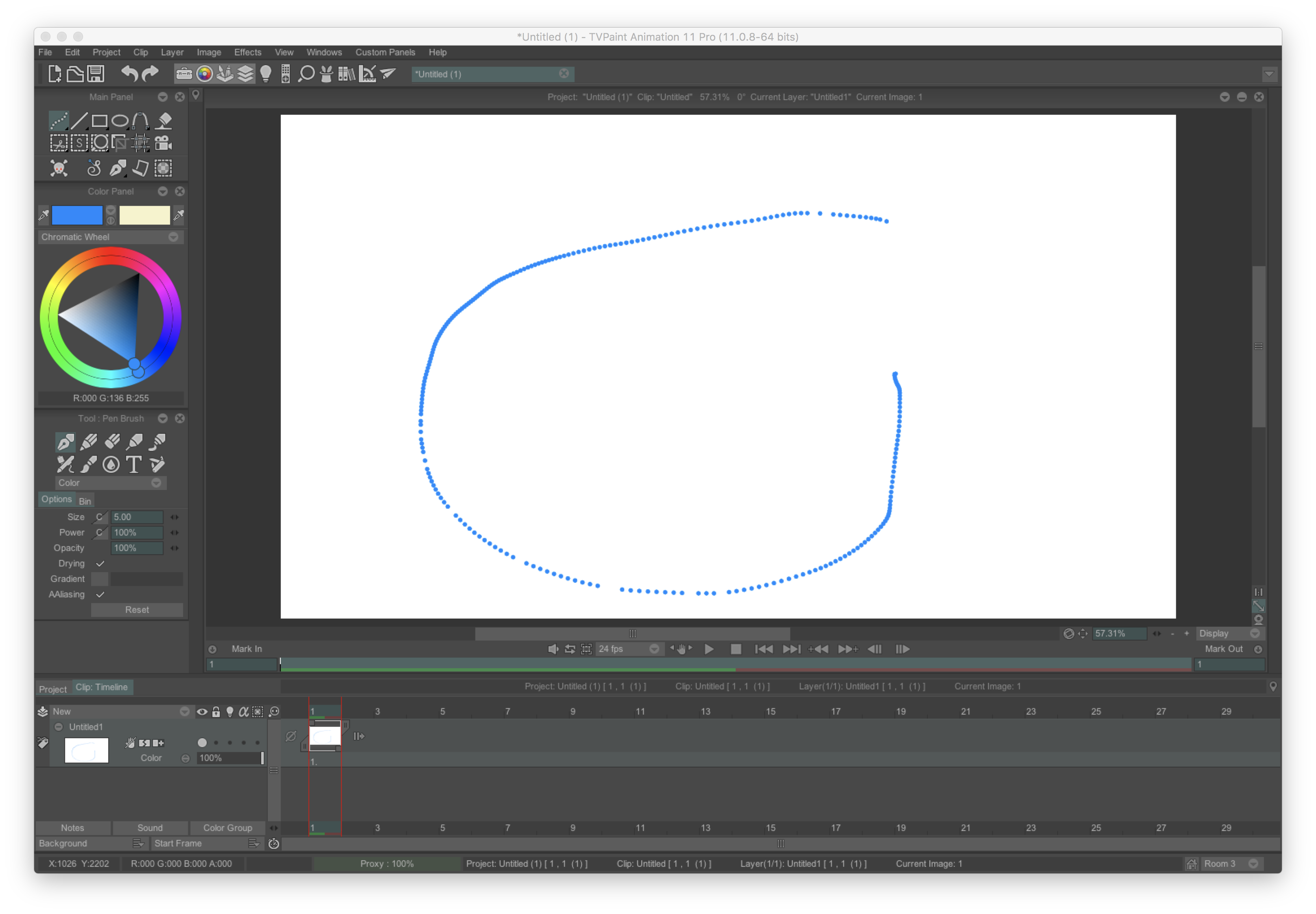

  • A new Color Picker has been added.
  • Public librairies used in the software (png, tiff, ffmpeg...) have been updated.
  • Shape: Freenhand Fill now onclide borders (like the Floodfill tool).
  • CTG Layers: a new option to apply current content on instances with the same name has been added.
  • A search area has been added to the PegHoles registration.
  • Features to draw lines with freehand shape have been added:
    • When using the freehand shape, press CTRL+ SHIFT to be able to draw lines from the last drawn point.
  • An option has been added to keep current position in the display flipping horizontally and vertically the display.
  • A Sketch panel without AntiAliasing has been added for Japanese users.

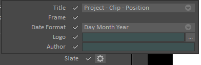

  • Fixed an issue when exporting Slate with camera view.

  • The correct frame numbers are now displayed when exporting a project/clip with slate activated.

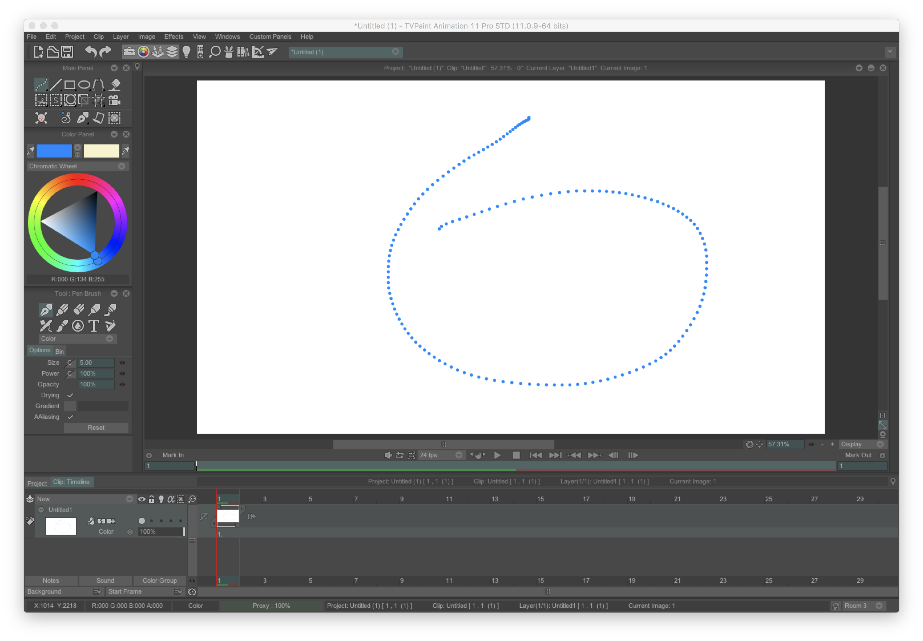

  • Drawing with Shift draws only points instead of lines when using a tool with drying enabled.
  • Drawing with Ctrl+Shift using average points linesmoothing no longer makes weird waves.

'Jagged lines' issue:
While we haven't managed to entirely fix the issue, we've done work to greatly reduce the loss of data and lag while drawing.
So now, when drawing, it should look more like this:
Instead of this:
We are still working on fully getting rid of the bug, and will keep you updated.

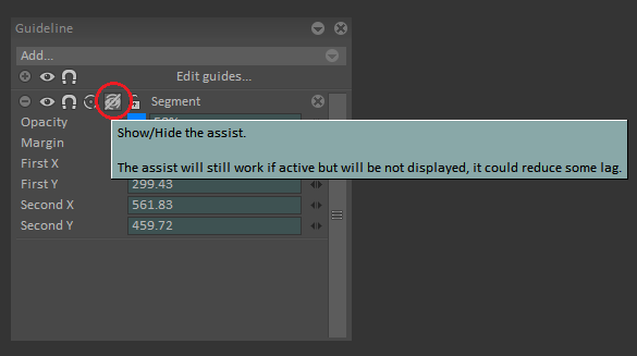

  • A button has been added to the following Guides, that will no longer display the visual cue of the Assist tool, while keeping the Assist tool active: Line Angle, Segment, Circle, Ellipse, Vanishing Points 1-2-3 (with and without lines).
    This will help with the lag that can sometimes happen on macOS

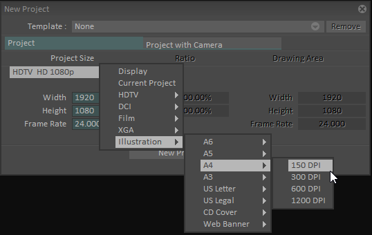

New Project creation:
  • “Pixel Aspect Ratio” and “Field” options have been removed from the Create new project window. Those options are still available when modifying and exporting your project.
  • Illustration presets have been updated with DPI informations:
    Spoiler : :
    v11.5.2:
    v11.5.3:
  • You can now delete templates in the New Project window.

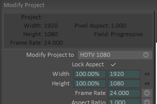

  • When resizing the project (whether it’s done with Modify project or tv_ResizePage), hidden layers are no longer cut.

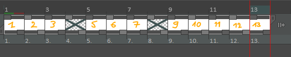

  • Empty instances are now easily recognizable:
    You can also choose to mark them with an “X”, in the Preferences > Display panel:

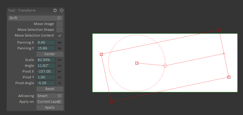

  • Rotation has been added to the Crop Tool.
  • You can now lock what’s out of the selection in the Warp Tool.
