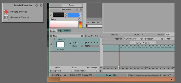

In TVPaint 11.0.1 the Tutorial Recorder will not record my entire screen, but only the lower left corner of the screen.
I only just discovered this because I don't usually use the Tutorial Recorder (I use a screen capture app called iShowU to record tutorials with sound) but today I decided to do a quick screen capture using TVPaint's Tutorial Recorder. When I clicked on Generate Tutorial I was very surprised to see that only a portion of my screen had been captured.
In iShowU the user can set the recording area (either the entire screen or a portion of the screen) but with the Tutorial Recorder I don't see any way to set the area being recorded . For some reason on my computer TVPaint is only recording the lower left corner of the screen .
This screen shot shows what was captured by the Tutorial Recorder after I click on Generate Tutorial.

I also noticed this since I got a new computer with a retina screen. It worked fine on my old computer so I assume it has something to do with the high resolution.
I am using TVPaint in low resolution mode by the way.

furushil wrote:I also noticed this since I got a new computer with a retina screen. It worked fine on my old computer so I assume it has something to do with the high resolution.
Yes, that was my first thought (re: the Macbook's retina screen resolution) . I changed TVPaint 11.0.1 to open in Low-Resolution mode and I tried changing the Macbook's display resolution to different resolutions , but each time I got the same results , where the Tutorial Recorder only records the lower left corner of my screen .
