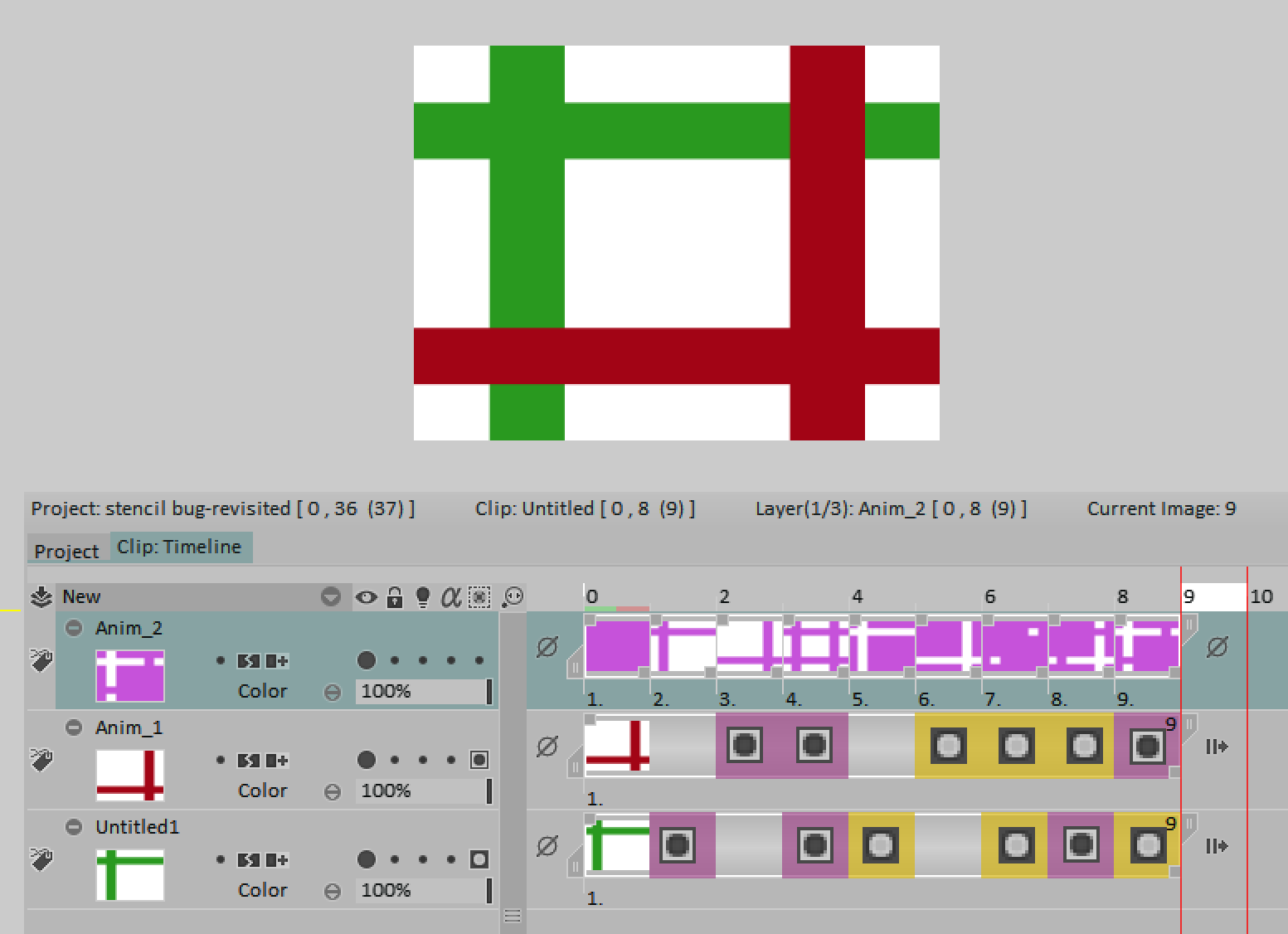

its tricky to get your head around but the stencil set-up is missing some result options.
these are the current options when combining two layers:
stencil bug-revisited2.png (43.8 KiB) Viewed 13624 times
i guess what i miss is the possibility to invert these results.
2 and 3 can be inverted (2>5 and 3>6)
but the rest cannot.

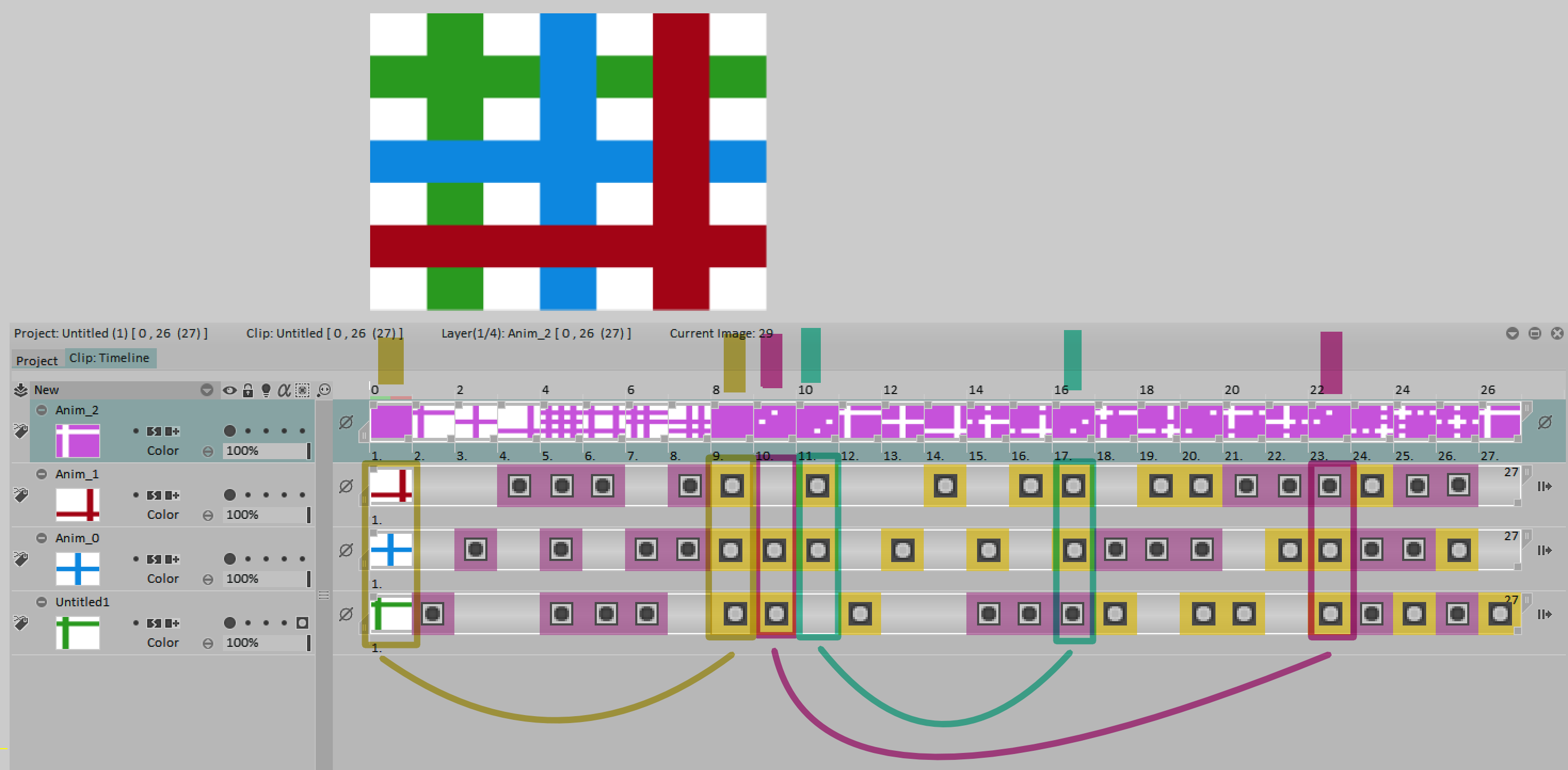

when i add a third mask layer thinks get very messy.
i tried to be systematic and noticed three times that some combinations gave identical results, while a host of results is not achievable with the current set-up.
for instance to get the inverse result of frame 5, a grid of white stripes, is currently not possible.
