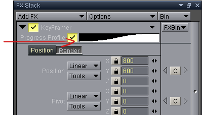

you can use the progres profile to counter this but it works only globally so you cannot control the dynamic of the separate axis, and the profile also lacks spline controls.

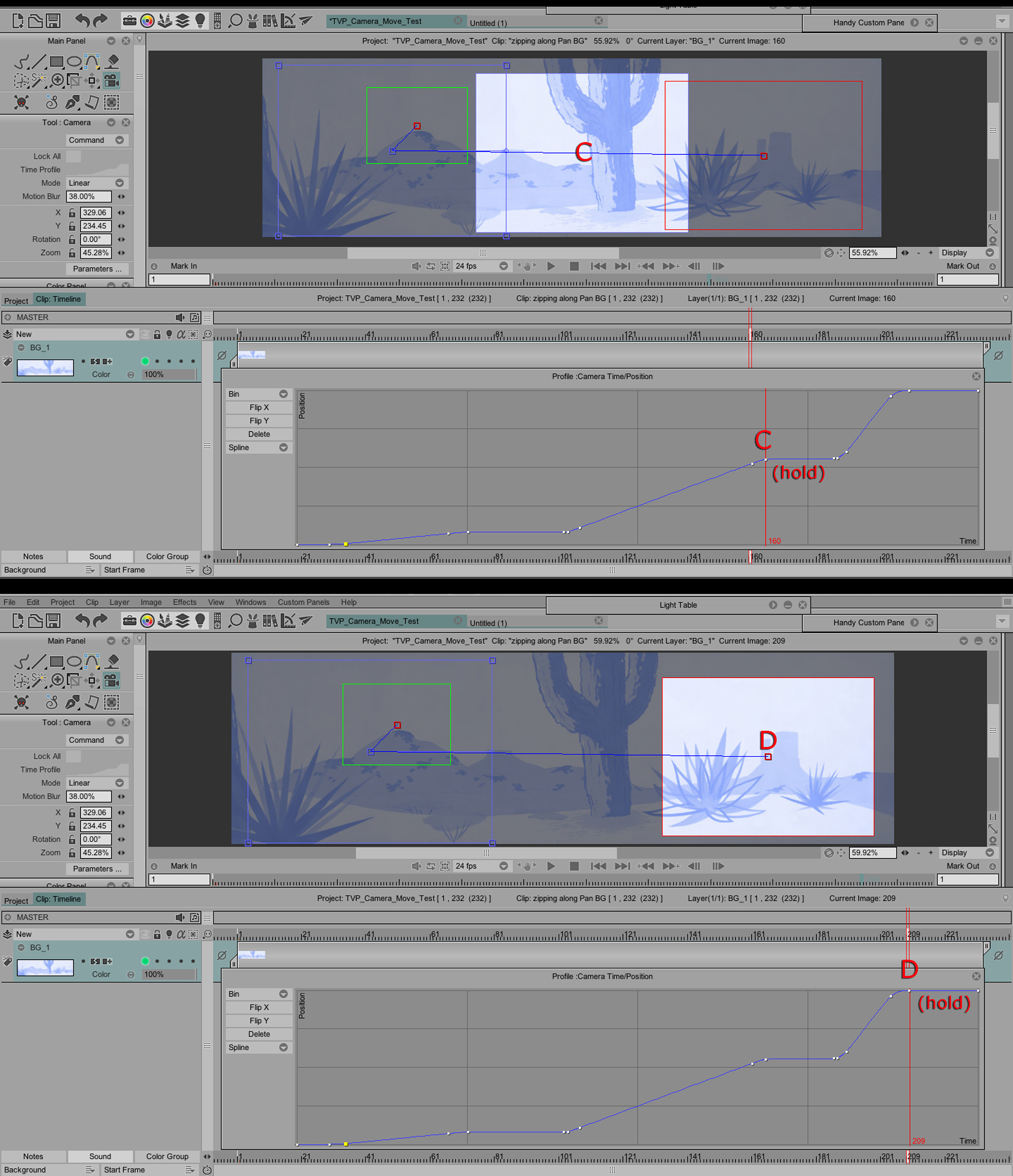

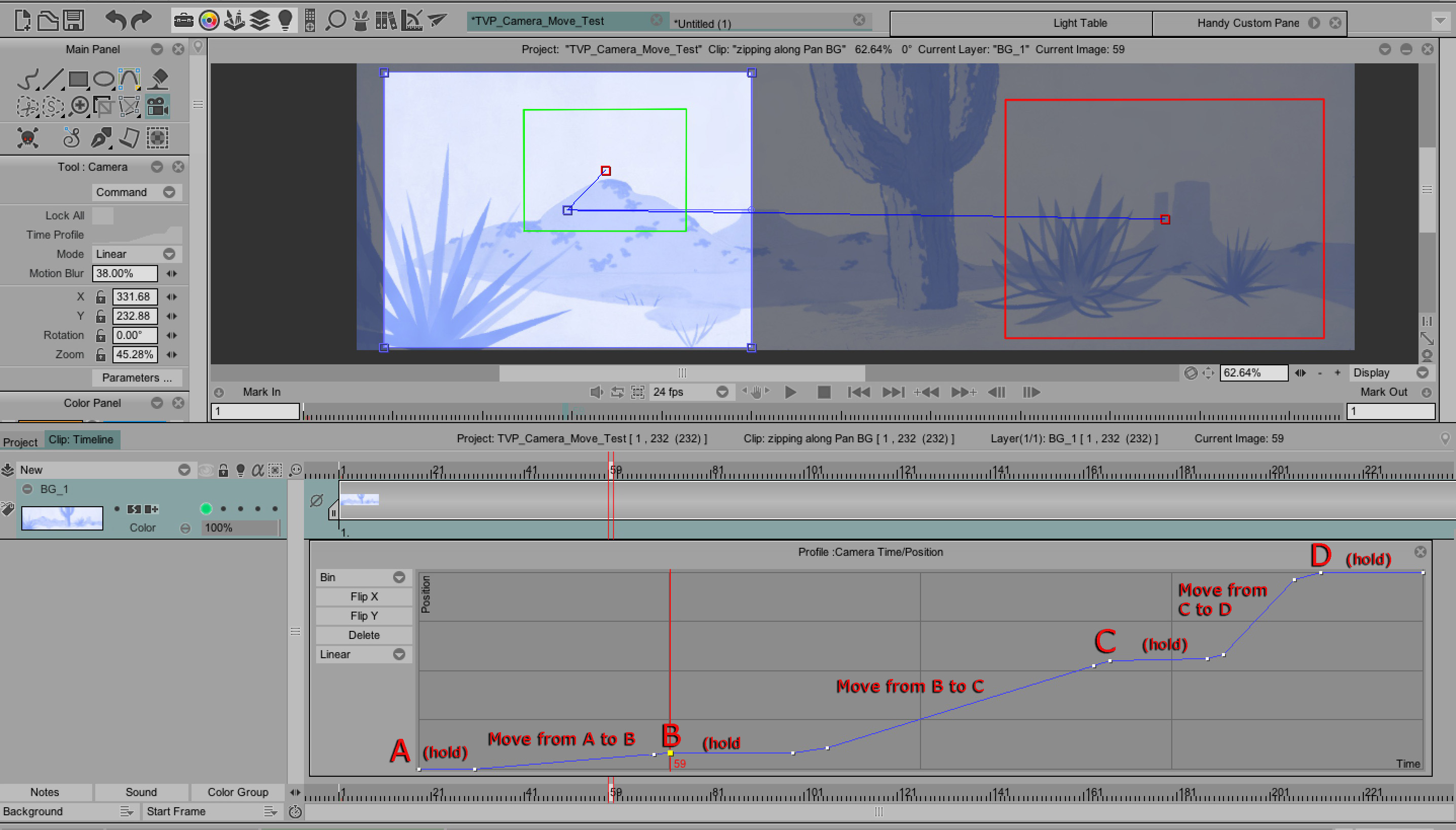

However, I will say this for the Camera Tool: if you can get a feel for using it , it is possible to do a simple Camera move from Point A to Point B , then Point B to Point C , then Point C to Point D (with holds at each point if desired) within a single clip .
See screen capture below. The flat line sections are the holds.
(click on the image to see it larger)
Still needs improvement. (and even with the current version there are no precise instructions in the user manual on how to add a HOLD in the middle of a camera move by flat-lining the time profile) .

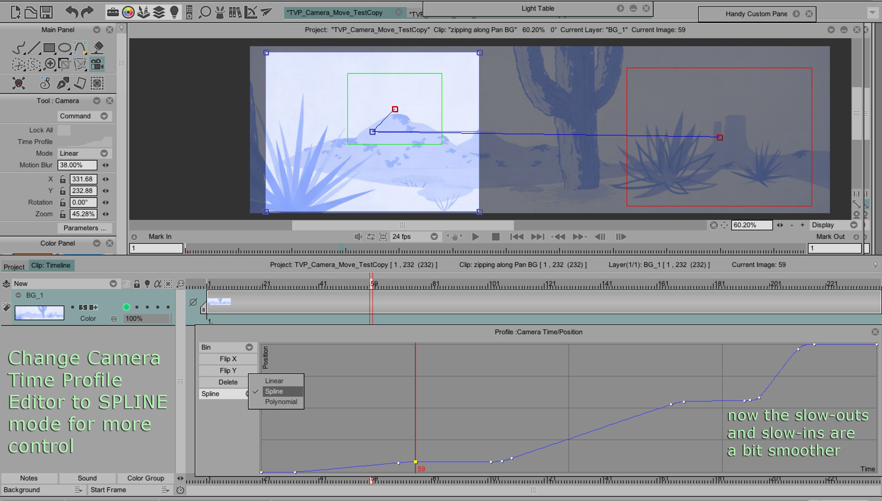

Switching the Camera Time Profile to SPLINE mode can make the starts and stops (slow-outs/slow-ins) a bit smoother . I'm not sure if that difference is apparent in the embedded .gif files here because .gifs can tend to play back at odd frame rates depending on the browser and the user's bandwidth , so it may look choppier than the original, but to me the same camera moves in SPLINE mode seem smoother than in in Linear mode.
(same move , but in Spline mode)

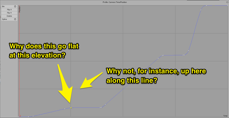

David, I too agree with everyone here when they say it 's not easy but once you learn the quirks it's not hard either. A good trick is to not just stretch the Profile window across the entire length of the clip, but also drag the bottom edge downwards to make the graph fat. Then use the Smart Spline setting and at each point place two keys close to each other. These two tips will make it easier to create a flat line because when the curve window is fat, you can observe with ease every increment where the blue line steps out of its horizontal.
As to your question how should you know where the horizontal line starts running flat, pay attention to the red vertical line representing your cursor's place on the layer. Also you have the exact frame number corresponding to that place in time showing at the bottom edge of the graph window.
EDIT: By the way, this is why I like multiple monitors, because you can stretch out the layer panel to a comfortable length and get a better close up view of every key. I can see how this might be much harder for you since you keep your layer panel on a single monitor (which I do as well, but have the capability to drag it across three monitors when working out a camera move such as yours.
EDIT, EDIT: I forgot to mention that once you have the two keys that are close to each other working the way you want them to go, as the last thing bring each pair together so that they become one. This way you will not get any wobbles.

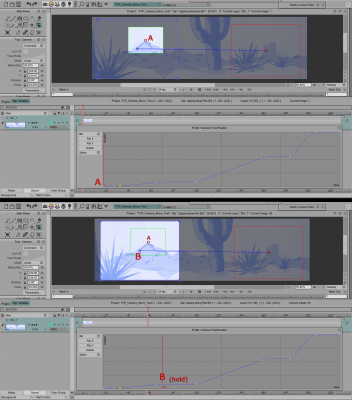

Paul highlights something very important that I should have mentioned in my earlier example : note that when I flat line the time profile (to make a hold) I am inserting an extra point (or "key" or "tip" as Paul says) very close to the point that designates the end of the hold. This helps to make it a motionless hold (no "drifting" or "wobbles") . This way I can get my camera move from Position A to Position B -- hold -- Position B to Position C -- hold -- Position C to Position D -- hold -- .
Also note that I created Position C (the hold on the cactus) not with a new point on the camera path , but by making a new point (key) on the Camera Time Profile and holding it (flat-lining it) , before proceeding to the end position D .
(Notice on the held positions B and C the second point that is positioned very close to the previous point which is the end of the hold. I didn't need the second point after the brief hold on Pos. A at the start , because that point is actually the slow-out from A . And at the end on Pos. D I don't need the second point because the camera isn't going to move again after it flat-lines at Pos. D )
And Paul is correct , if you expand the Camera Time Profile (on a separate monitor, if you have one) it's easier to manage .These two tips will make it easier to create a flat line because when the curve window is fat, you can observe with ease every increment where the blue line steps out of its horizontal. By the way, this is why I like multiple monitors, because you can stretch out the layer panel to a comfortable length and get a better close up view of every key. I can see how this might be much harder for you since you keep your layer panel on a single monitor (which I do as well, but have the capability to drag it across three monitors when working out a camera move such as yours.

in the KeyFramer_FX, you have to enable the Progress Profile (see pict.),David_Fine wrote:...
On a separate subject, in the Keyframer, having designed a move successfully, how do I control the ease in and out curve the way I want? That's not immediately clear.
then, double-clic the curve thumbnail to open and edit the profile in its window,
(by default, the speed-curve is flat, an upward straight diagonal).
it's a "global" profile, from start to end of the KF effect,
so, when you have only two keys, setting a speed curve it's easy as pie,
but when you have more than 2 keys, the inbetween keys position on the timeline
will sort of "float" away (forward/backward) regarding the curvature of the profile.
warning : don't try to edit any KF key position when a custom progess profile is set on,
disable the progess-profile first, edit the key(s), then enable it again,
otherwise, it's a pain in the ass when trying to clic on and move a point,
(you'll inevitably generate unwanted new extra key(s) ...)

After working on a recent project I have come to the conclusion that the workaround method ZigOtto outlines above gives the most control and is easier to manage in the end , as long as you can get used to the idea that to do a series of 3 or 4 simple camera moves -- From A to B -- B to C -- C to D -- D to E -- you will have to split your Scene into 3 or 4 clips to apply the camera moves from point to point , then merge the clips in the end make it a single scene again. For me this has turned out to be a much faster process than trying to control the camera moving and holding within a single scene by flat-lining the points on the Time Profile . ( It can be done , but it requires a lot of fine-tuning of the points , so it is more effort. )ZigOtto wrote:
1) the Camera tool route : for a A>B>C>D move with some holds on B and C,
- I split the Clip in 3 clips, A>B, B>C, C>D,
then, you will have to set 3 simple (2 pts) moves,
- set Frame A and Frame B into the first clip,
- go to next clip, "RMB/copy last point of previous clip" to copy frame B into the second clip, set Frame C,
- go to next clip, "RMB/copy last point of previous clip" to copy frame C into the third clip, set Frame D,
this method is ok when the timing is validated and definitive, otherwise it could be a problem,because the camera speed will change with the timing change.
to preview the whole thing, in the timeline panel (project view),
go to the 1rst frame of the 1rst clip, enable Mark IN,
go to the last frame of the 3rd clip, enable Mark Out, then "Play".
It's an awkward workaround , but it does WORK. The thing that bothers me is : how does the new user ever learn about this ? They won't get it from the User Manual as it is currently presented. (for example , it's not obvious from the User Manual that you can do what Zig suggests: RMB/"Copy last point from previous clip" to transfer the point from clip to clip ... how does anyone find out about this other than by regularly reading the forum and getting lucky to stumble upon a thread like this one ? Most users don't spend time participating in this forum, so the procedure has got to be covered in precise, step-by-step detail in the User Manual .

You are very right about that and this is perhaps one my biggest issues with TVPaint. The manual is lacking and outdated and vital information about how to use the program effectively needs to be garnered from places like this, which is very hard for the new user. How can a professional program be sold without it providing these very important and basic details about how to use it? I know, the team is small and we have this great forum, but really, it does shock me that there is this much discussion on the forum from seasoned users just to figure out how to do a camera move. This is very basic functionality and should just work.
As regards using the camera tool, I am still confused about how to know when to flat line in terms of the vertical position. I know you use the timeline to see where the red line is horizontally, but that does not tell you how high to raise the line to flat line when you want to hold. It seems entirely arbitrary.

David, it just occurred to me; do you have your view finder activated when you plot your camera move? I ask because if you did, you would see where your camera's position (view) is in time and space. The difference between your left arrow's position and the right one would show as two different zoom-end positions and that gives you the height along the graph.
In the same way, to decide whether the speed curve should be closer to the left or right means a change in the speed of the zoom.
The over all length of the clip tells you how long the holds should be. The longer the length of the clip, the more time you have for the camera moves.
All these positions come through when you start of by using your view finder and set your graph first to linear -- everything else on the graph falls into place. Then change linear to spline and add a second key close to each first one from which point you can tweak the slow ins and outs.
