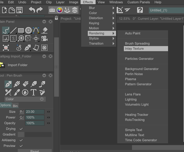

Are you accessing the Inlay Texture effect through the menu or by opening the FX Stack by clicking the "magic hat" icon Image in the upper toolbar?
Screen Shot 2023-01-21 at 9.53.14 AM.png (75.32 KiB) Viewed 7637 times
Screen Shot 2023-01-21 at 10.01.35 AM.png (34.04 KiB) Viewed 7633 times
Are you using version 11.7 or 11.7.1 ?
I recall a few weeks ago some people reported an issue with the first version of 11.7.1 where opening an FX via the menu caused TVPaint to crash. I believe the issue has been fixed in the latest build of version 11.7.1 (released Dec. 22, 2022 ; if yours is before Dec. 22, 2022, updating should fix the issue)

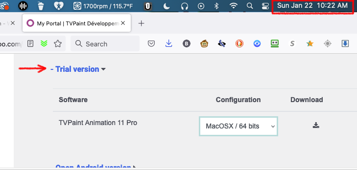

It seems that someone forgot to update the Demo version , because I downloaded the Demo version today (Jan. 22, 2023) to check it and I can see the date is Oct. 27, 2022. So the available demo version is not the most recent version of TVPaint updated on Dec. 22, 2022. Hopefully TVPaint will email your license code soon and you can update it to the latest version 11.7.1 released on Dec. 22, 2022. I think that will fix the crashing problem wth the FX Stack.
Screen Shot 2023-01-22 at 10.22.34 AM.png (55.1 KiB) Viewed 7576 times

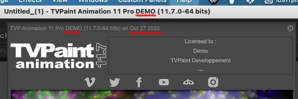

When I opened the Demo version and checked under the Help Menu > About TVPaint Animation,
it shows that it is from Oct. 27, 2022 -
Screen Shot 2023-01-22 at 9.30.50 AM.png (50.02 KiB) Viewed 7588 times
