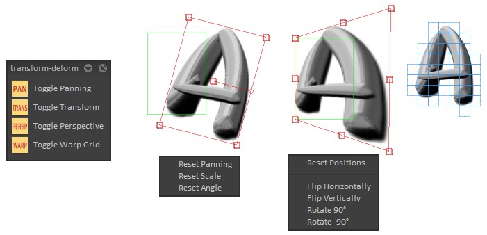

A simple set of TOGGLE buttons that give direct, toggle-able access to the Transform and Deform operations when assigned to shortcut keys.
On my keyboard, I've assigned the Transform-Deform Buttons to the H, J, K, L keys so that:
H = Deform on / off
J = Pan on/ off
K = Transform (pan, scale and angle) on / off
L = Perspective on/off
Toggle the key once puts you in the assigned mode, toggling the key again takes you out of the assigned mode and updates any change you might have made.
H - toggle to bring up warp/deformation grid and, after deforming, toggle again to make the deform permanent, and dismiss the grid.
J - toggle to start Pan and toggle again to exit Pan mode which updates the re-positioned layer.
K - toggle to enter or exit Transform mode, the RMB click brings up the Reset operations for Panning, Scale and Angle.
L = toggle to enter or exit Perspective mode, the RMB click brings up Reset option, but also permits flipping and rotating.
Drag and drop the Transform-Deform.tvpx file into your TVPaint 11 application. Assign shortcut keys in the usual way.
The Warp/deformation button only works with TVP Pro 11, but the other three buttons (Pan,Trans,Persp) will work with TVP Standard 11 and earlier TVPaint versions.
